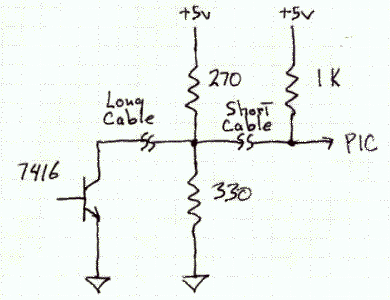

Can you make a small schematic of your buffer stage ?
Sorry, I don't understand what you mean. I added resistors to +5 and GND, no buffers.
can you take some oscilloscope pictures of the Write Data line synced on the Write gate line during sector writing ?

ok i didn't understand.
So if understand well you have added a pull up and a pull down resistor ?

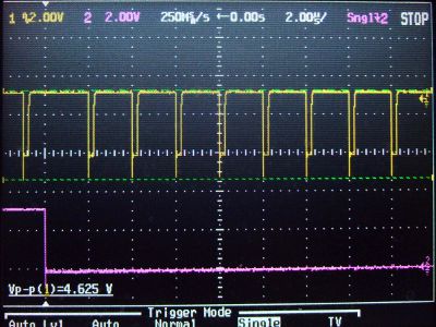

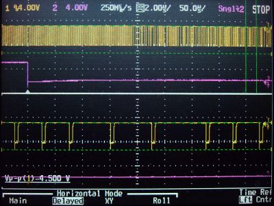

Jeff wrote:Another point : can you take some oscilloscope pictures of the Write Data line synced on the Write gate line during sector writing ?
I borrowed a DSO. See the attached photos. The second photo shows that "data" begins to appear on WD about 180us after WG goes low.
Yes, see the drawing. A typical termination is 220 ohms to +5 (but I used 270 because of the 1K already on the emulator) and 330 ohms to ground. That equates to a termination impedance of about 129 ohms which is ideally near the impedance of the cable to minimize reflections but more importantly it is low enough to charge the cable capacitance quickly. The line driver is open-collector and requires an external pullup. The resistor network effectively connects it to +3V through 129 ohms. 3V is well above the logic "1" threshold, at least for TTL.

top: WD and WG; bottom: WD windowed and delayed to show actual data

The write data input are in schmitt trigger mode. The minimum high voltage is 0.8*VDD=0.8*5=4V. 3.3V high voltage is too low.
So i recommend you to remove the pull down resistor or if you prefer increase its value to obtain at least an high voltage of 4.5V.
Another question : what is the write data pulse length ? 500ns ?
That's a very high threshold! The Schmitt Trigger receivers (74LS19) on the mainboard (for RD, etc) switch at about 1.9V on a positive-going transition.
I will remove them.
It is 250 ns. But if you look at the first 'scope photo I posted, before adding resistors, you can see that without them the emulator would stretch it to ~500ns if it switches at 4V. (Maybe that's why it didn't work then?) It will be somewhere between if I keep the 270 ohm resistors to +5V.

In fact the very first picture looks good enough to me. Don't forget that this is an open collector bus. the "slow" raise time isn't the problem here.
Generally HD/500kb/s FDC generate a 500ns pulse.
Do you know the threshold for a low-going transition?
1V
