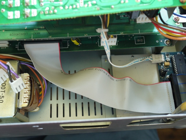

Initially the disk LED was permanently on so I opened the S950. The floppy connector on the mainboard of the S950 (see the attached picture) is reversed. I cut off the plastic thing on the plug on one side of the ribbon cable, so i could connect it in reverse. Now the LED stopped being permanently on.

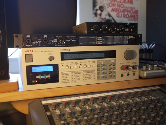

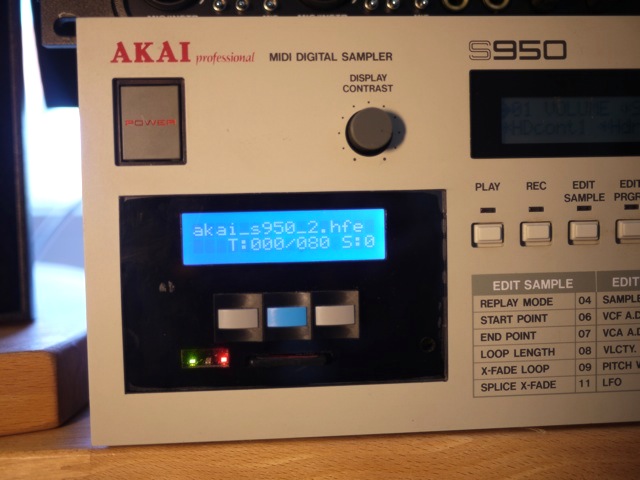

Finally, the floppy emulator is integrated in my S950. I'm looking forward to make a video of using it, but I don't have the time. So I start with share some photos.
My dad and my brother (big thanks!!!) cut a perfect hole in the front panel (where the floppy drive slot was) and build a nice plexi glas front panel (painted black from the back). The pcb is mounted on an aluminum plate fitting the old floppy drive slot.
The biggest problem was the data cable to the 950 main board. It looks like it has to be as short as possible (weak signals?).
Reading and writing works perfect but there is a problem with changing floppy images while the 950 is running. A disk is only recognized if it's mounted when switching on.

Here is a picture of the floppy cable. It's cut of a regular pc floppy cable:
