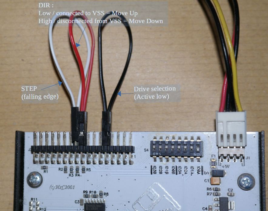

Thanks for the video. It seems that there is maybe an issue with the "DIR" signal. Can you check if this signal change its state ?synthprof wrote: Sun Dec 28, 2025 2:04 pm Hi,
Thanks for the help so far. I had to break away from this project but had some time over Xmas to take another look. I have basically followed the comprehensive instructions to the letter, but I am still getting the same issue as before. All I can conclude is that perhaps the FDD controller in this analyser is defective, however, the drive is trying to change side and seek so perhaps not. Let me show you a video of the problem and see if you can work out what is going wrong.
https://drive.google.com/file/d/1pSA0tt ... share_link
Watch carefully now! Analysers seem hell bent on sending to heads to a track which doesn't exist. So much in fact that the HxC device thinks it must go into LBA mode to seek it! I have no idea what is going on. All of the images and wiring instructions for the drive are off the shelf. These are the very same results I got last time so I am at a loss.
The only thing I can see is that line /TRK00 is always low, which might explain some of the seeking difficulties.
Next step is the recycling centre, regretfully.
Best wishes,
Andy
If it doesn't : Maybe there is an issue with a buffer in the machine.
If it does: Maybe there is an issue with the emulator regarding the DIR signal. You can test it without the machine with some jumper wires by strapping the drive selection line to the VSS and making some contacts between the VSS and the STEP signal with the DIR connected to the VSS and after this disconnected. You should be able to move the head in both directions.
This may also be an issue with a damaged floppy ribbon.

Re: HxC and HP1650A
mhh i have see (again?) your mov video file, and i still have doubs about the "DIR" signal (hxc pin 18) : the tracks counter still increasing and is never decremented even when you retry after you press a key to retry, which is quite surprising, and probably not related at all to the image : finally I still think that there is something wrong around this DIR signal...
Have you an oscilloscope ? If you do, please connect the DIR and STEP signal to the oscilloscope with the emulator, Set the trigger on the falling edge of the STEP signal. choose a timebase to see the step signal rising and falling edges.
There is maybe an timing issue around the STEP (hxc pin 20) and DIR (hxc pin 18) signal relationship. The machine may update the DIR signal right before the STEP rising edge, and the emulator use the falling edge as strobe...
This can also be a signal level issue...
use the sd hxc rev f to have an easy access to these signals.
if you have a 4 channels oscilloscope, please add the drive selection (pin 10 or 12) too on the traces.
The "A" on the screen is quite odd too... I would try to force the drive signal (pin 10 or 12 depending of the switches configuration) to vss to see if the behavior is different.
EDIT : It seems that you had a better behavior in a past post : viewtopic.php?p=25982#p25982
What have you changed since to have the current regression ? the issue seems intermittent..
