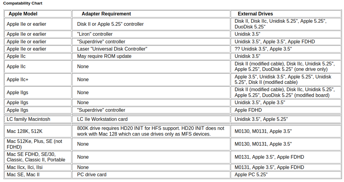

Re: Apple II Support
First point : Apple II controller / drives compatibility Chart :
Screenshot at 2023-10-12 22-10-28.png (158.13 KiB) Viewed 38068 times

So to sum up :
- All 5.25" Apples drives are 140KB sized at max. (Disk II interface)
- To have more than 140KB -> 3.5" Drives -> These drives use the Smartport protocol.
This seems to be a very different project than a simple Disk II emulator. The timings needed to capture and acknowledge the bus commands and the very different signal usage versus the Disk II interface seem to be quite challenging to make it work on the gotek. I don't say this is impossible - but sound challenging.
Anyway this is far to be just an image support problem.
