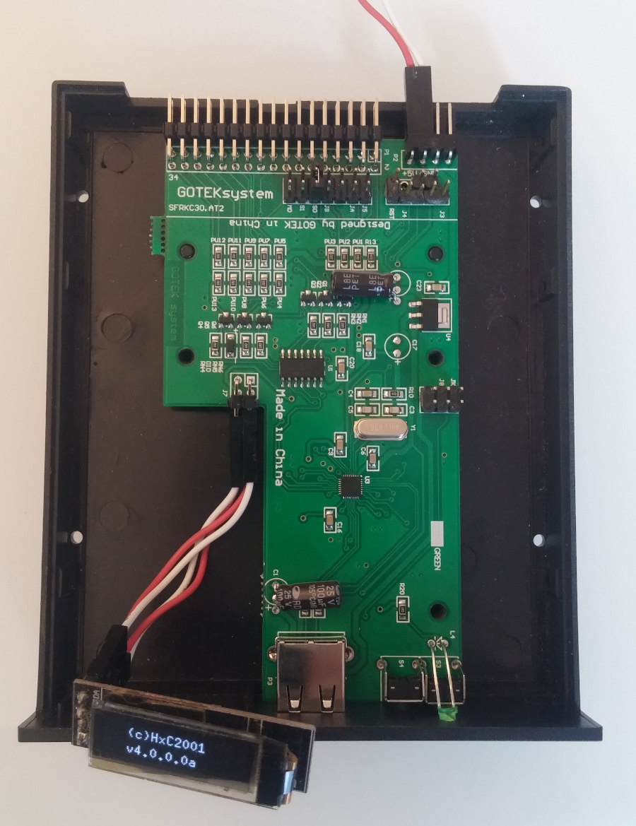

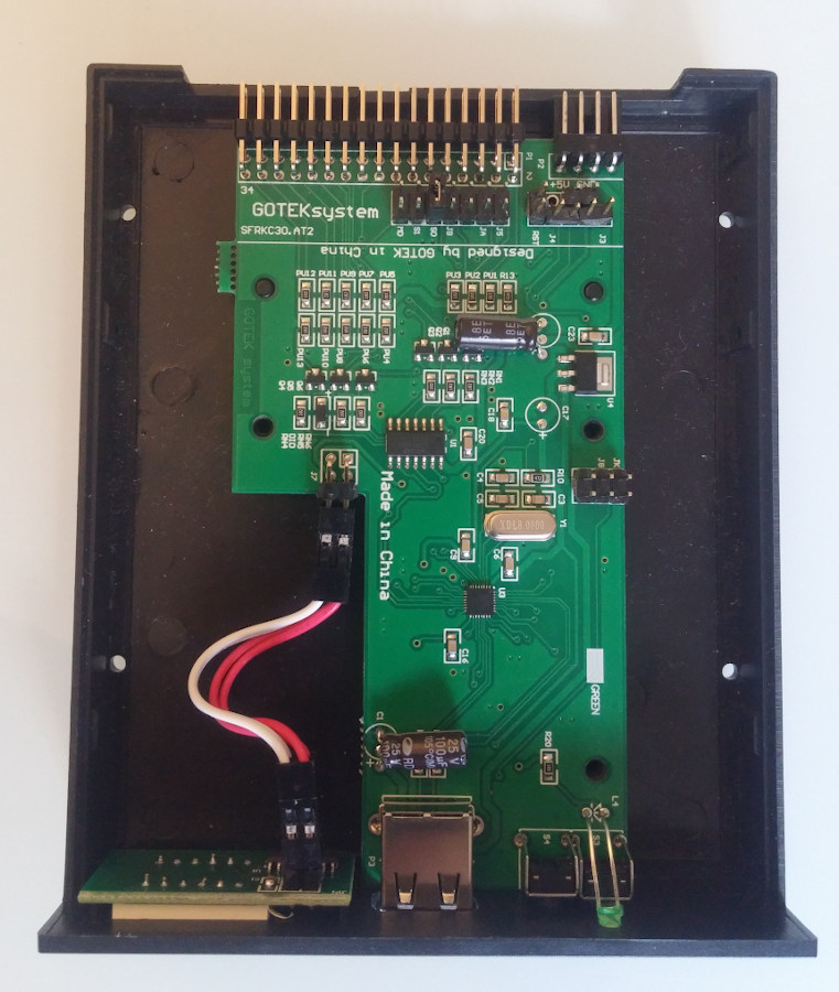

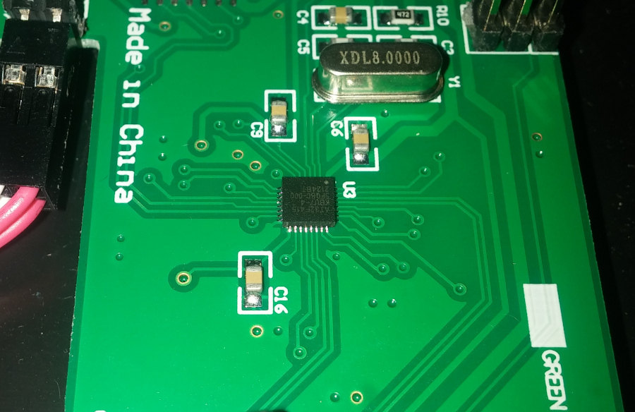

The electronic components shortage isn't over and things are getting worse. Even the AT32 chips are getting harder to find and now Gotek System is constrained to use the MCUs available on the market.
That's why since two weeks a new Gotek with a 32 pins QFN AT32 MCU is present on the market. (PCB Reference : SFRKC30.AT2)
The HxC Firmware is currently being modified to support this new hardware revision :
The release is planned this week.
We can expect more designs changes in the near future.

The first v4.X.X.X firmware supporting the SFRKC30.AT2 have been released in the "New_SFRKC30_AT2_Gotek" folder :

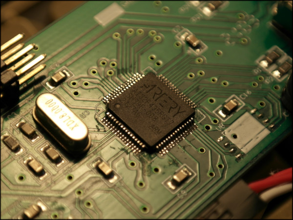

A new series of Goteks based on the new AT32F435 is now available (PCB "SFRKC30.AT4.35") :
This is a very good news because this MCU is more powerful than the previous AT32F415 MCU.
- The AT32F435 has 384KB of RAM ! (This was 32KB for the AT32F415 and 64KB for the STM32F105)
- The AT32F435 can run at 288MHz ! (This was 150MHz for the AT32F415 and 72MHz for the STM32F105)
This upgrade suppress the 32KB memory size challenge introduced by the "SARS-CoV-2" Goteks (based on the AT32F415).
This is definitively more reliable with more memory because file cache can be properly implemented to deal with the USB stick latency.
If possible i now strongly recommend to get AT32F435 Goteks.
Regarding the HxC firmware :
- The bootloader was updated to support this new chip.
- The firmware was updated to support this new chip. (Working - Still the the OLED/I2C interface to do)
- The server/distribution stuff still to be updated.
I hope to release the whole stuff in some days. EDIT 8 August 2022 : DONE ! : viewtopic.php?p=24863#p24863
(Contact me by email if you want to be a beta tester : hxc2001 at hxc2001 dot com)
