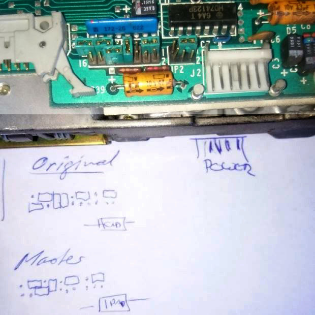

Unfortunately, I don't have any manuals for the FDD-412A drive or the controller, and I was not able to find anything on the Internet. So any more detailed description would be welcome!
Here is our current jumper assignment in the Okuma Campus 5000 systems:
Okuma Campus 5000 Jumper Settings
Thank you for your help!

So my question is which set of jumpers are currently working in the Campus 5000?
The jumpers marked "original" or "maoles"???
And where did you get the other jumper settings?
I'm confused as you have a VFO drive, and are using RD jumper settings in one example and VFO jumper settings in the other.

m.vgunten
Posts: 19
Joined: Sat Jan 18, 2020 5:56 pm
Location: Bern, Switzerland
Re: Hitachi FDD-412A 8 inch floppy drive
Post by m.vgunten »
Sorry for the confusion! :o
The drives connected to the Campus 5000 are using the Master jumper settings!
The Original jumper settings are not uesd in our system setup!

joeyd
Joined: Fri Jan 10, 2020 10:06 pm
Post by joeyd »
Your "Master" configuration is VFO.
It will require a VFO board for the HxC to work with the controller.
