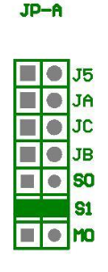

Another point : Is the gotek jumper set to S1 and all others jumpers removed ?
Re: Yamaha A3000 HxC Gotek
Jeff wrote: Fri Dec 14, 2018 9:21 pm Another point : Is the gotek jumper set to S1 and all others jumpers removed ?
According to this previous Yamaha A3000 + SD HxC user feedback the jumper setting is important. A wrong setting appears to lead to an half-working situation. From my point of view this appears to be the case too with your setup :
viewtopic.php?f=18&t=3021
SD HxC ID1A switch is equal to the Gotek S1 jumper setting.

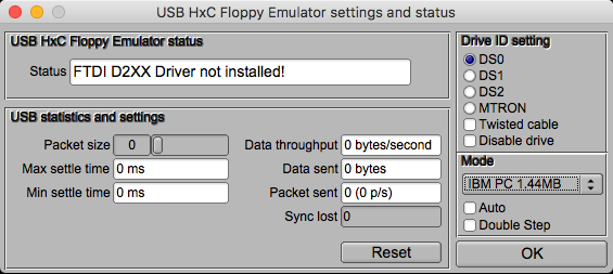

I'm using indexed mode with a 1.44mb Gotek. Do I load the config file in the sdhxc settings? I have a usb key version so I thought I don't need to use the sdhxc settings. At what point should I load the CFG file. When I load a working image with data is the CFG not included as part of that? At the moment I've been loading the CFG file 1st (load iamge). Is this correct? It's on the root of the key as required.
Is there a way of having a larger floppy image size with my setup?
So far I'm using the import function on the sampler but I have to load each file in the list one by one which is very slow. And as I said when I move to a different floppy image with the gotek buttons the disk image access is lost until I re-access it in the 'Disk' functions of the A3000.

Here is my HxcUsb settings.
USB settings.png (58.84 KiB) Viewed 91859 times

JMack wrote: Tue Dec 18, 2018 4:12 pm Hi Jeff,
Yes jumpers are correct.
Only one is needed ! please remove the others.
JMack
Posts: 18
Joined: Fri Dec 07, 2018 11:44 am
Post by JMack »
It is configured like this>
