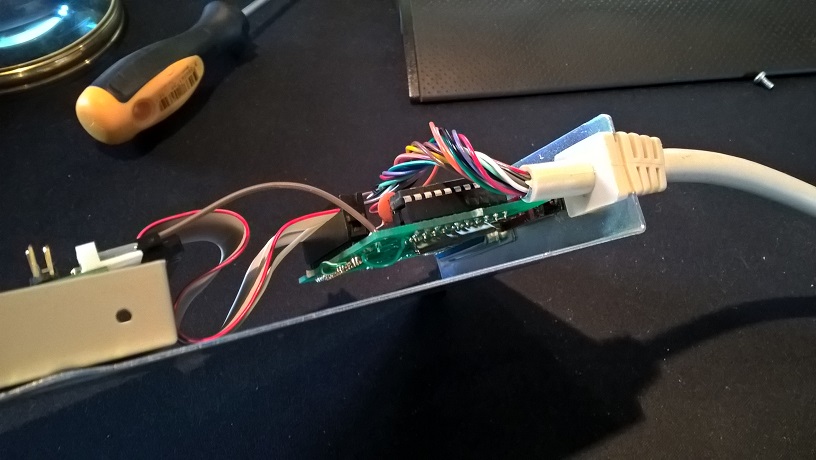

Inside the beast:
I should add that I made a custom short floppy cable to fit inside the enclosure but I tried with the original cable and another full size floppy cable with exactly the same result.

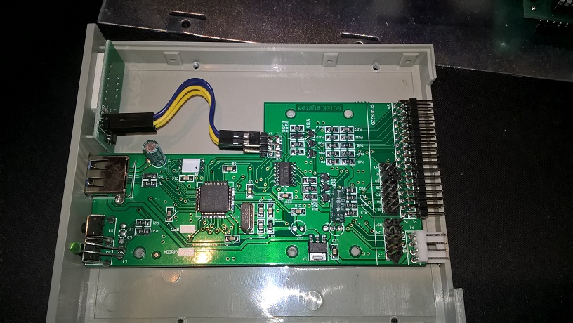

Re: "Autoboot" / File selector mode working except for HXCFEMNG
Why you don't have connected the VSS/GND gotek power supply wire ?
Yes this is also weird in this enclosure.
Only one wire (power) is connected to the power connector...
This is how it was when I opened the enclosure the first time.
I assumed the ground was going through the other connector.
The wire was directly soldered to the drive power connector so I replaced it with a removable connection.
As the Gotek drive powered on correctly I didn't think too much of this...

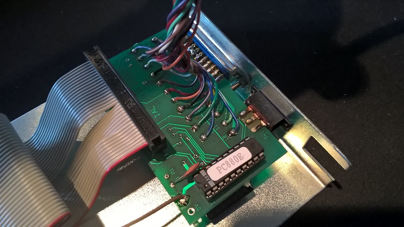

What is this IC on the picture ? An PAL or something else ?
After searching a bit I found this forum thread which discusses various Power Computing enclosures with a few pictures:
http://eab.abime.net/showthread.php?t=64016

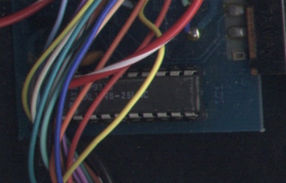

Here is a zoomed picture of the IC without the sticker: Is this readable enough for you or should I reopen the enclosure and remove the sticker ?

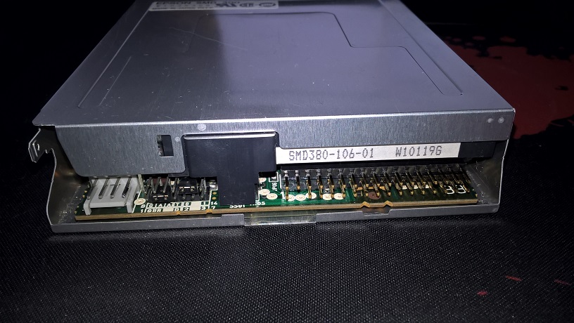

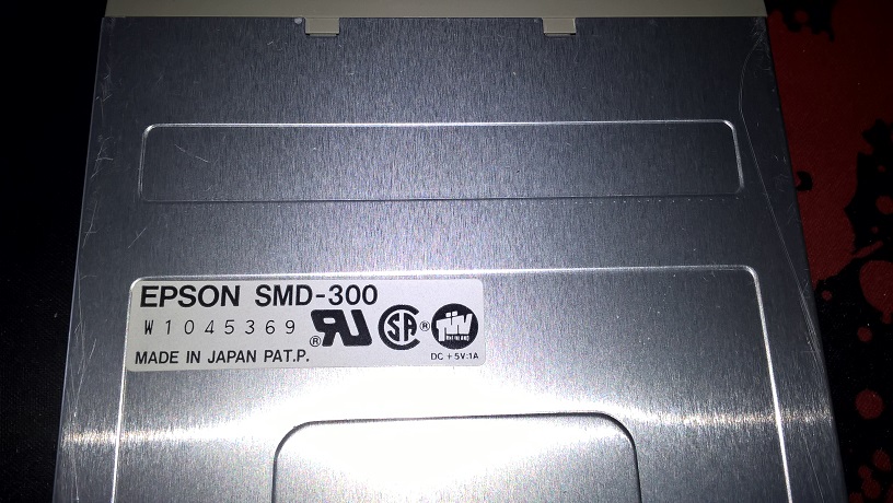

The original floppy drive is an EPSON SMD-300:
well it says SMD-300 on the big sticker but SMD-380 on the back...

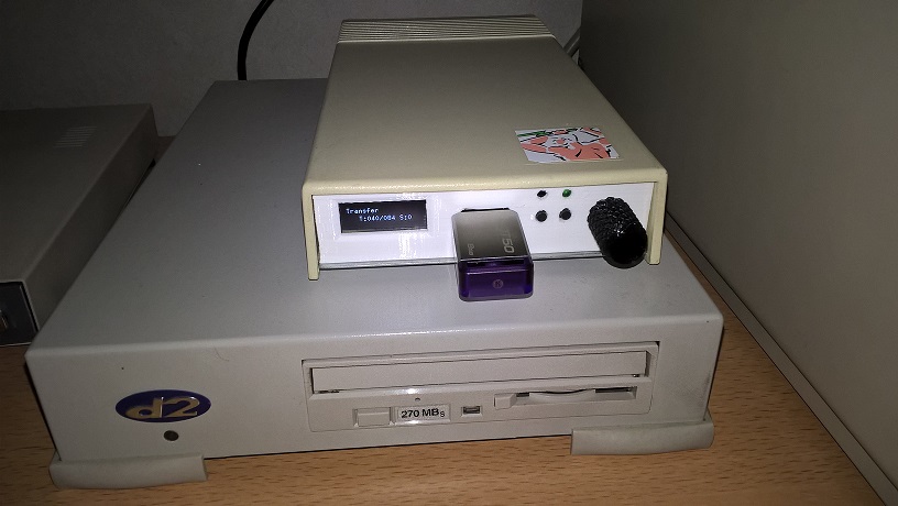

I finally installed an OLED screen and a rotary encoder:
I can confirm that this Power Computing enclosure works fine with this configuration.
In the end everything seems to work fine with this enclosure except HXCFEMNG on the Amiga.
I hope this information can be useful to someone.
