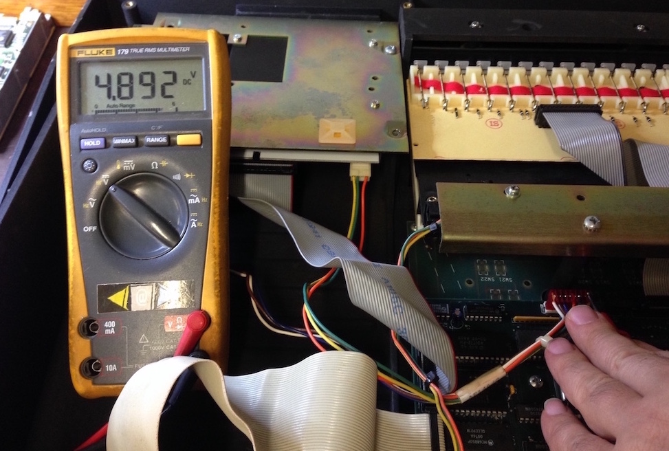

It's 4.8V

Jeff wrote:What is the voltage on this yellow wire ? please measure it.
It's 4.8V
Would you be able to send the emax II os? I've tried a few but non of them working! I don't even know whether it does boot or not! Thanks

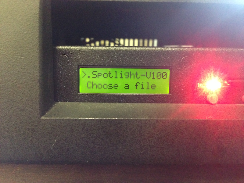

What is displayed on the HxC LCD with an image selected/loaded ?
"Please Insert Disk !"
The Hxc drive shows some file names but does not show OS file/ or name etc!

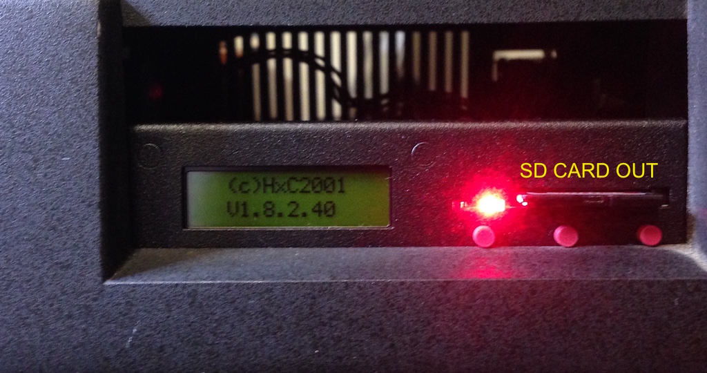

Re: EmaxII makes noise with HXC & does not boot the OS. HELP
Please make a picture of the HxC Lcd.
As asked by the emulator , please choose a file image and do a picture of the hxc lcd.
Motomix
Posts: 21
Joined: Thu Feb 11, 2016 3:48 pm
Location: Australia
Post by Motomix »

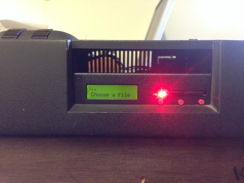

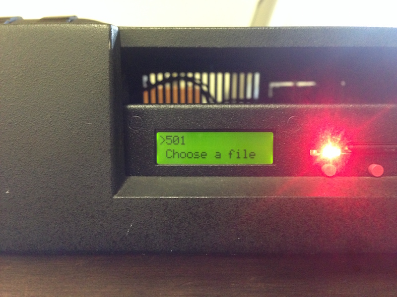

Jeff wrote:As asked by the emulator , please choose a file image and do a picture of the hxc lcd.
The first photo from top is when I trying choose a file but there is nothing to be chosen! I'll get more photo when I got to studio!
Ok sure that this explain why nothing work. :wink:
Have you copied some HFE files to the SDCard ?

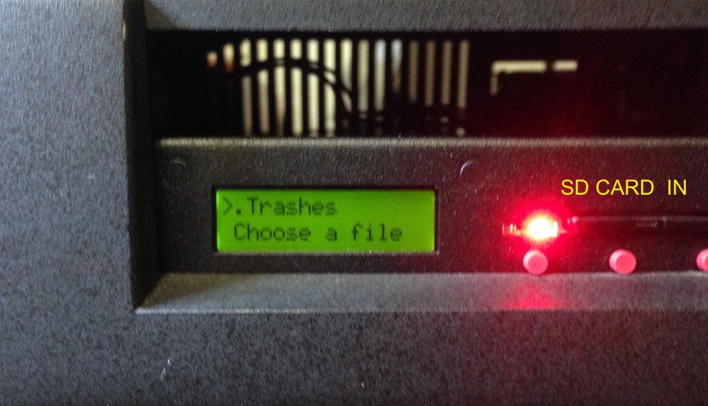

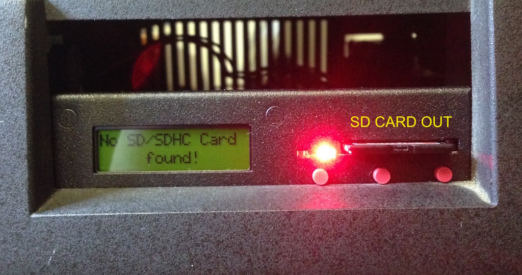

Yes, I've done that a few times with different settings however I might doing this in wrong a way hence I've asked you if you have these HFE files for eMaxII!
Here are some the example when trying to choose files with the drive!
I have added the Emax II package into this archive :
Unpack the emax II zip file to the root of the SD Card.
