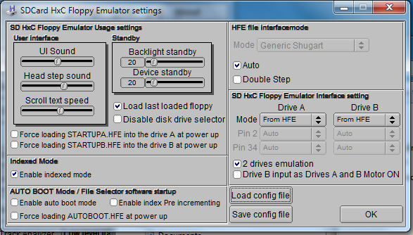

Hello Jeff, did you mean rename to DSKA0000.CFG?. As I understand it, the SD card has only the CFG file on it initially, and then any writes by the scope hardware to the "floppy" are stored as HFE files by the floppy emu. Can you correct me? or be more specific?
I checked the HXCSDFE.CFG setting using the HxCFloppyEmulator software, and it appears to have indexing mode on. But its set to emulate two floppy's which does not seem right ? (attached)

I renamed the HXCSDFE.CFG to DSKA0000.CFG, and now when I insert the floppy LED flashes constantly at about 2/3 Hz. No sound, still the same error on the scope.

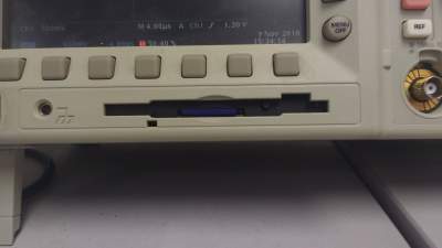

Here is the finished TDS 3000 with HxC floppy emulator installed.
I had to band saw about 12mm off the length of the metal backplate to match the size or the original TEAC floppy. I use a 150mm FFC ribbon cable from RS components 122-2608 as the original FFC was too short for the HxC.
With 4 "disks" on the SD card, I have now been able to update the scope firmware, which has now given me free math "modules" for FFC and Dual Wfm, thanks!
