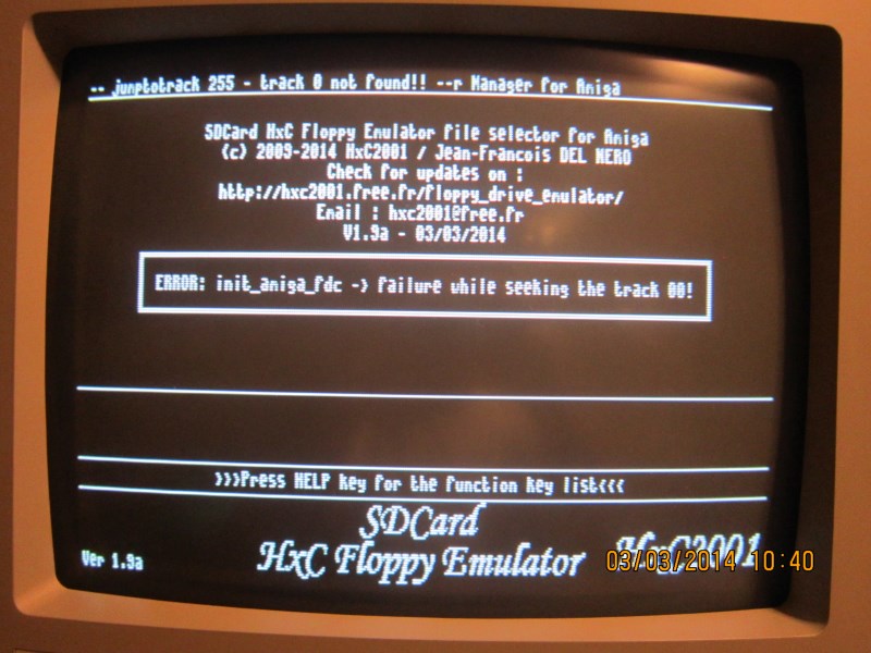

Ok, I just ran the debug version. It froze as well at this attached screen. Any ideas?
Re: AUTOBOOT problems

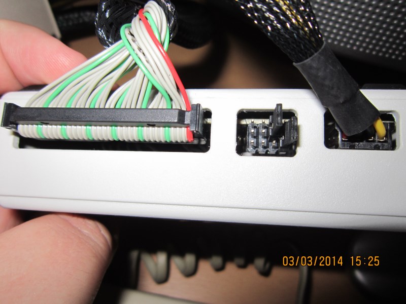

Ok for sure you have a jumper setting problem : the drive is not selected by the software so you don't use DS0 as it should...
Can you a picture of the jumper ? Are you using a twisted floppy ribbon?
eightbit
Posts: 10
Joined: Sun Mar 02, 2014 9:08 pm
Post by eightbit »
Do you think it is the cable or jumper setting? Why does everything else work just fine?
