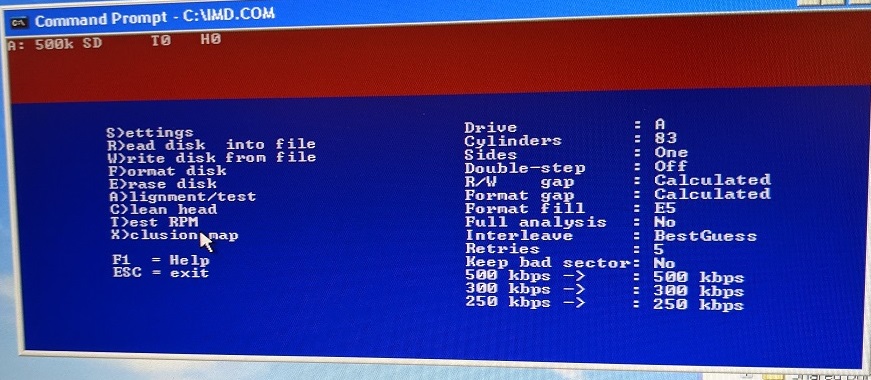

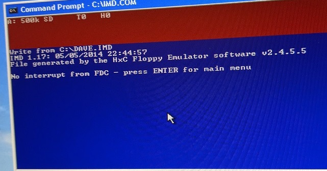

This board is great, I have been stuck with so many dead ends, I never touched a floppy drive before this.
I am looking to write the provided imd file here to a floppy, though as an outsider I am finding it incredibly difficult to use imagedisk.
Tried using dosbox on windows 10 with a 1.44mb drive read/writer from amazon(being sure to mount the a drive as a floppy) where when I click to write it doesn't list the idm file or allow me to navigate around. Also trying to clean or measure the rpm seemingly does nothing.
I found an old xp machine and that can boot up and then run imagedisk on, even has a floppy drive. Following Steven's guide, I formatted a 1.44mb floppy selecting it as a boot disk and covered up the HD box? Running imagedisk off of command prompt it now says something at the top, and when trying to find the file to write I can actually navigate to it. Trying to write now it says "No interrupt from FDC"? The old xp machine probably has a 1.44 mb floppy drive too if that makes a difference.
Any help would be very greatly appreciated!

Re: HP 4145B Semiconductor Parameter Analyzer
ImageDisk should be run on a pure DOS machine. I don't expect it to work on Windows.Friendly911 wrote: Mon Aug 16, 2021 1:50 am This board is great, I have been stuck with so many dead ends, I never touched a floppy drive before this.
Here is some ImageDisk bootable floppy images :
https://hxc2001.com/download/floppy_dri ... d_boot.zip
Disconnect any harddisk present in the machine, and boot the imd_boot disk from a floppy disk or a floppy emulator. ImageDisk will be copied into a ramdisk (C:) at boot. This way you can dump a floppy disk to the ramdisk. After this don't forget to copy the .imd file present in C: to another floppy disk (or another floppy disk image on the emulator).
If you want to write an imd file, copy it to the c: ramdisk. you can try to edit the imd_boot img file to add it directly to the boot disk.

Woo I got it working, Jeff is real legend, keeping this board active and helping soo many people with old hardware.
I could not get the file Jeff provided to work, burning it to a floppy and booting off it. Though thank you so much for trying and sending that over.
For all those in the next 10 years reading this, this is the 2021 solution I used.
You need an older computer that has a floppy drive to motherboard, a usb-floppy will not work as it communicates with the unit differently.
I used 1.44mb floppies, the last type and all that I could find. Tape over the box in the bottom right corner so the drive thinks its a 720kb type which you need.
Open cmd and format the drive by typing: format a: /T:80 /N:9
Then make a bootable usb with freedos, a common usb formatting tool called Rufus can be utilized for this.
Drag the imagedrive files afterwards to the usb along with the Startup_HFE.imd(rename to something shorter)
Otherwise attached are the files from the usb I used:
https://mega.nz/file/73BknDYZ#XLaKALR9o ... LmzBfk8iKU
Boot to the usb and run the imd file, for my files that means just typing C:\imd\imd
That will launch image disk, at the menu press esc then S to edit the settings. As older posts very kindly mention the details are:
Drive: A
Cylinders: 83
Sides: One
Double-step: Off
R/W gap: Calculated
Format gap: Calculated
Format Fill: E5
Full analysis: No
Interleave: Best Guess
Retries: 5
Keep bad sector: No
500kbps -> 500kbps
300kbps -> 300kbps
250kbps -> 250kbps
After this press esc to stop editing the settings. Then press W, select the S1 file or whatever your renamed Startup imd file is called, you can navigate with the arrows keys. Press enter and it will start to write to the floppy.
