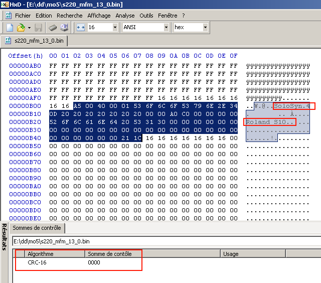

So with some of my "quick and dirty" bruteforce tools i managed to find how is encoded the data !
I know now :
-> The sync word used
-> How to decode the datas
-> And which CRC is used to check the data integrity.
So the header is valid !
:D

So now i can tell that the last test with the 5.0s files are valid regarding the different data blocks (3 blocks with valid CRC). We shouldn't be too far from something working. probably a ready signal timing issue.
