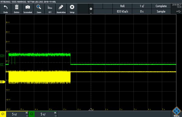

I have started testing on a S220 with a working QD. The first thing to note is that the "normal" save cycle has three stages. A read of the disk to see if its empty or not, the whole disk is read rather than just the initial "header", then a write cycle and then a read cycle to verify the data.
A fast F1 save, skips the first read of the disk and has the write followed by the read.
Both types of save fail on verification. I will trace the real QD now
Fast Save to HxC Read and Ready signals
Fast Save - Read and Ready.jpg (52.26 KiB) Viewed 49918 times

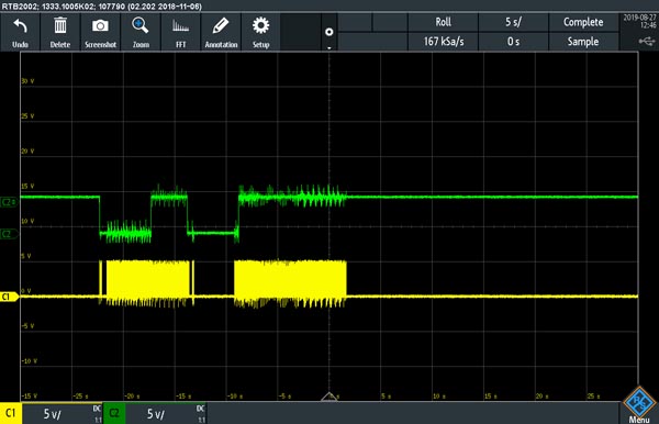

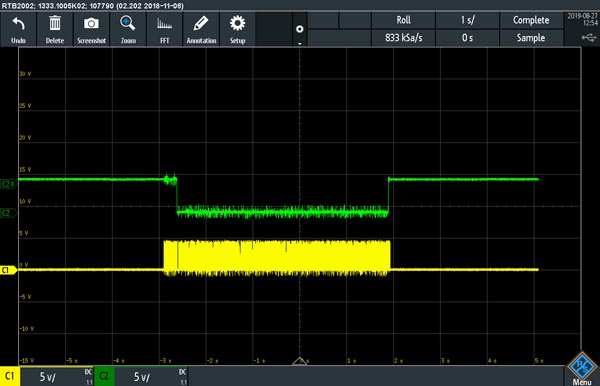

Read QD, Fast Save and then a Load
Load - Ready and Read Data
RealQD - Read Cycle.jpg (51.06 KiB) Viewed 49917 times
Fast Save - Ready and Write Data
RealQD - Write Cycle.jpg (51.26 KiB) Viewed 49917 times
Re: 2.8" QD Disk Emulation
AMSynths wrote: Tue Aug 27, 2019 2:00 pm Read QD, Fast Save and then a Load
- can you do the same capture with the write gate instead of write data ?
- What is the exact ready signal assertion time ?

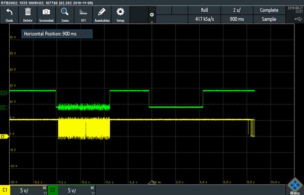

Write Gate and Write Data trace is attached.
Ready assertion time is 4.5 seconds during the write and 4.5 seconds for the read verification.
All on Fast Saves - no checking of the disk first.
Fast Save- Write & Write Gate
Fast Save - Write & Write Gate.jpg (50.6 KiB) Viewed 49913 times
AMSynths wrote: Tue Aug 27, 2019 2:43 pm Write Gate and Write Data trace is attached.
Wait ! I see two glitches on the write gate at the beginning ?! Is it real ? Can you zoom them ?

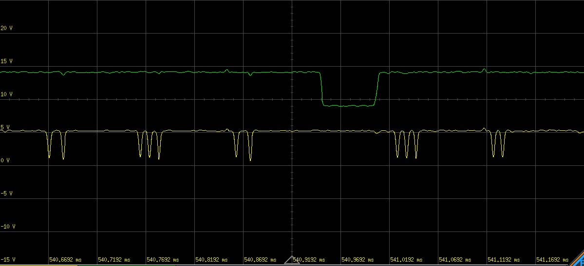

here is the detail of the Write Gate glitch, it happens maybe 1 in 4 times, not every time.
its not me moving the probes..
Detail
Detail
RealQD - Write Gate Glitch Detail.jpg (75.01 KiB) Viewed 49909 times
Real QD Write Gate Glitch
RealQD - Write Gate Glitch.jpg (70.6 KiB) Viewed 49909 times
AMSynths wrote: Tue Aug 27, 2019 3:55 pm here is the detail of the Write Gate glitch, it happens maybe 1 in 4 times, not every time.
This can definitively disturb the software. now i suspect that main header is not recorded (lost) i have to check if the wg filter is enabled and if it is "strong" enough.
