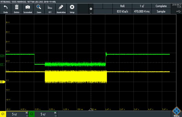

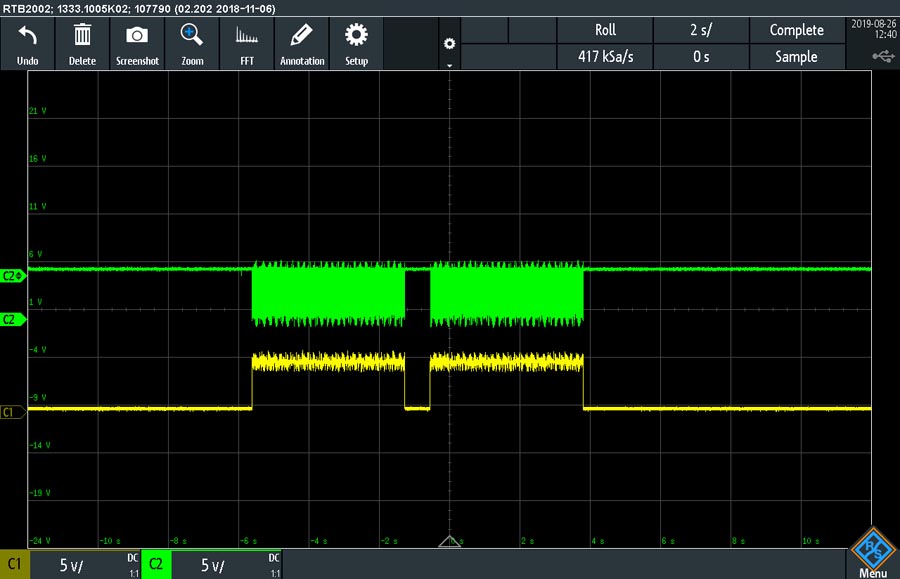

Write Data and Write Gate - see oscilloscope trace. Gate stays on as expected. Not sure why verify has write data.
I will take a look at the read data line
Write Gate and Write Data trace

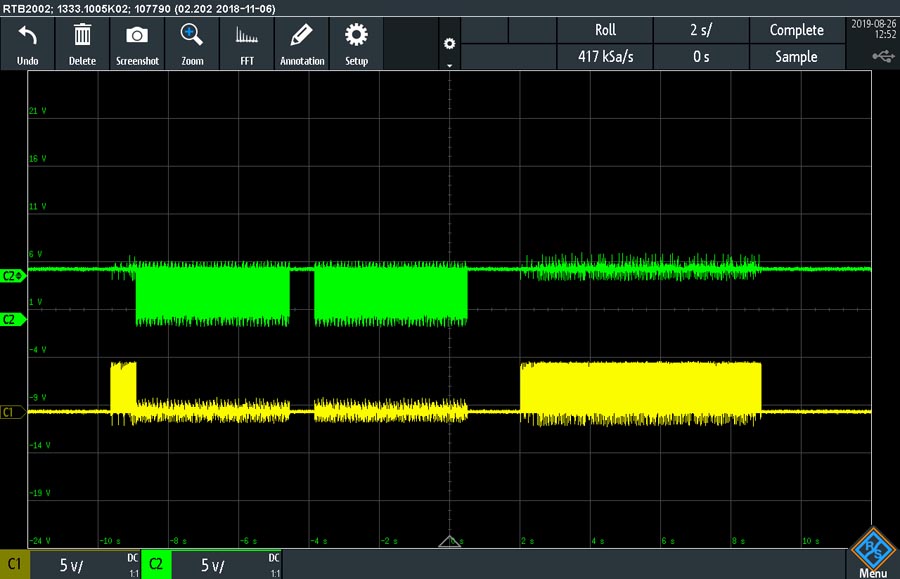

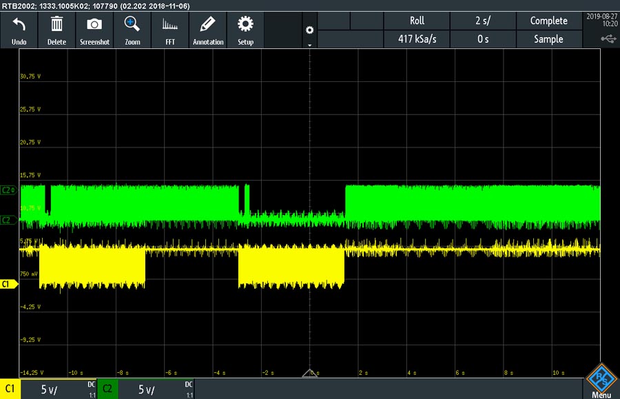

Looking at a trace of read and write data lines it becoming clearer what happens in a disk write.
The S220 reads the QD initially, to see if it contains any sample data, it doesn't - so it continues with the write.
It is writing twice and then does a read but only if its a fresh file. The writes are longer than the read in total.
This was with the ABCD banks or A bank with a sample time of 4 or 1 seconds.
The verification failure is at the end of the second write cycle, not the read.
The read block only happens the first time the file is written to.
According to the Write Timing Diagram there should be read data coming back during the write.
There is read data coming back during the write but its much lower than normal read level.
Protect and Motor On signals are the same as the diagram - correct.
QD Write - Read and Write Data lines

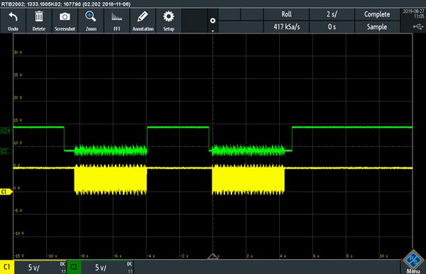

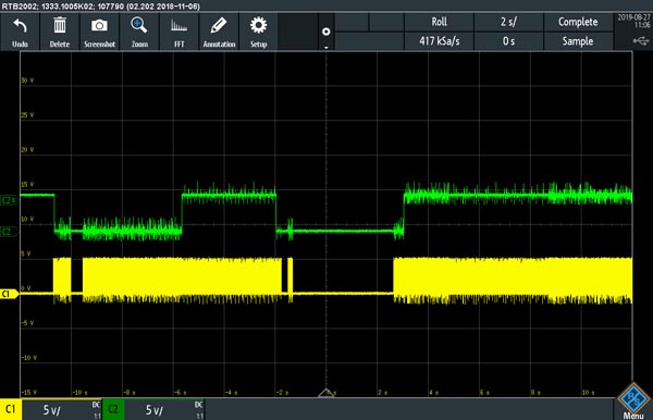

Not successful...traces below. 4.5 seconds and above look better with the reads but still 2 write cycles.
4.7 seconds
4.7 seconds
4_7 seconds.jpg (94.21 KiB) Viewed 85336 times
4.5 seconds
4.5 seconds
4_5 seconds.jpg (94.31 KiB) Viewed 85336 times
New firmware 3.4.1.7
FW 3_4_1_7.jpg (90.36 KiB) Viewed 85336 times

Re: 2.8" QD Disk Emulation
AMSynths wrote: Tue Aug 27, 2019 11:30 am Not successful...traces below. 4.5 seconds and above look better with the reads but still 2 write cycles.
Can you add the ready trace ?

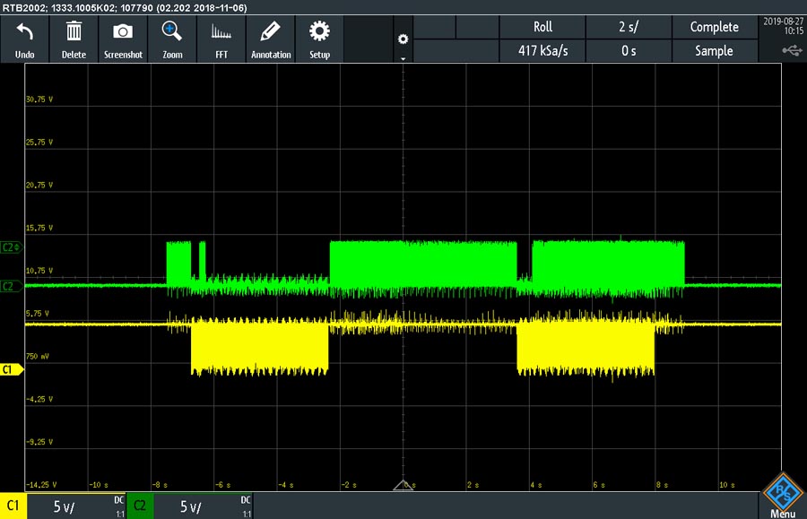

Read and Ready trace
5 seconds Read and Ready.jpg (55.74 KiB) Viewed 85329 times

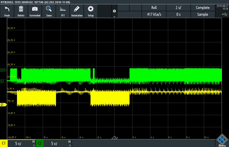

Write and Ready trace
5 seconds Write and Ready.jpg (52.61 KiB) Viewed 85329 times

AMSynths wrote: Tue Aug 27, 2019 12:12 pm here we go....
Thanks. The tracks appears to be fine now. We can see the track structure with the 12 bits samples ; )
Now the question is xhy there 2 write and xith you can t read back them. Probably another ready issue . have you a working qd drive ?

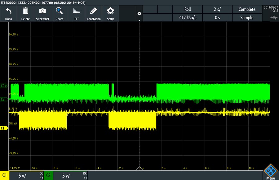

Looking at the 5 second trace, the first write cycle is taking longer than 5 seconds and the ready off cuts the data off. Looks like it takes 5.2 seconds to check disk and then write the data.
5 second ready signal with write data
