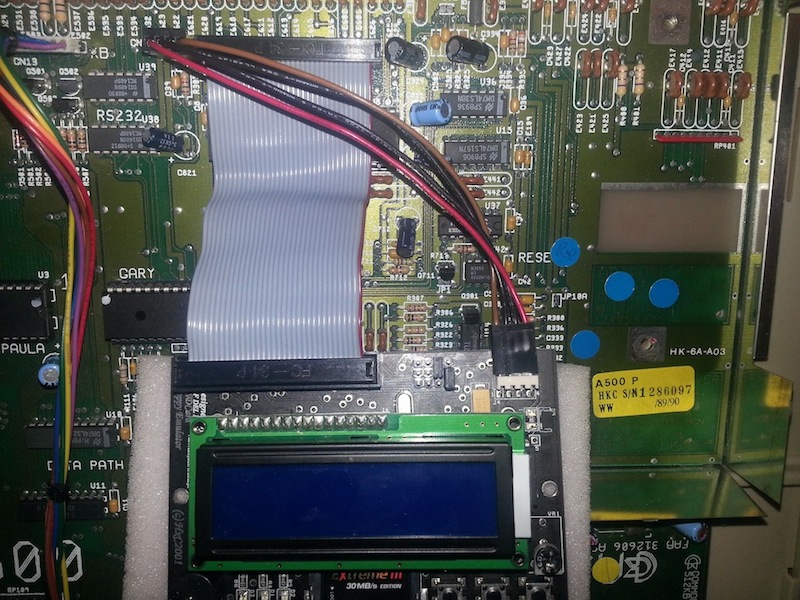

A picture of your jumper setting please...

Here is a pic of the jumper settings.
Thank you Jeff in advance for your advice

jumpers I have not touched,
are like the photo above are
