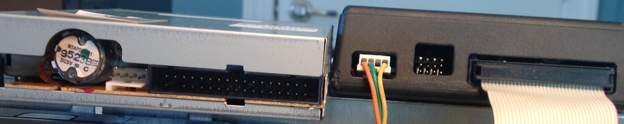

Post by dykesh »
Hers is a picture of the original floppy drive and the hxc external drive. Thanks

Re: Emu EOS 4.7 Question
dykesh wrote:Also, this is a regular scsi cable, it is not twisted.
But there is no jumper at the HxC side ?!

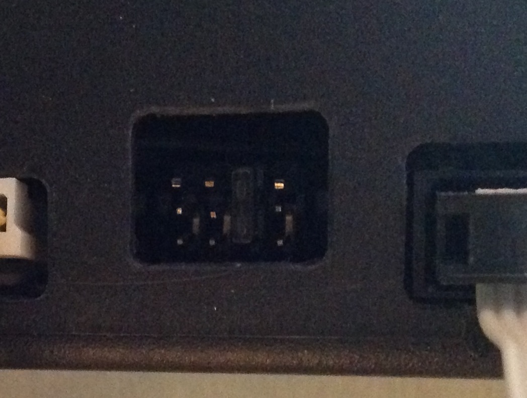

Post by dykesh »
I have the standard two pin jumper that comes with the HxC. I placed it there on the upper two pins based on what the manual says for pc compatibility. The e5000 still asks for a floppy disk rather than seeing the fat32 formatted sd card.

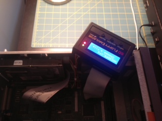

i see anything on the picture with the lcd, picture too small.... what is displayed ?
