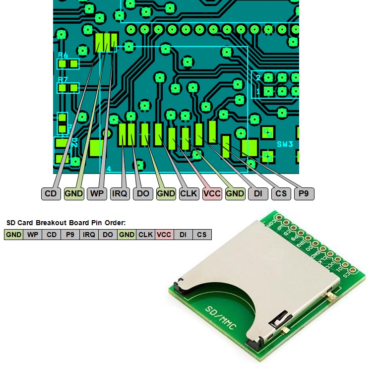

I just picked up a SD-MMC break out board.
Model BOB-00204: http://www.lipoly.de/images/sparkfun_00204.jpg
I am hoping to mount it to a 5 1/4" faceplate for my Emulator II (along with the LCD and buttons of course). I am fairly novice when it comes to electronics but I am trying to learn whatever I can. I have managed to wire the LCD and buttons properly. However, this I am a little lost on. Can anyone please advice me as to which pins I need to connect on the HXC2001 board to the specific pins on the SD card breakout board itself?

Using wires for the sdcard will probably make the device unreliable (signal integrity problems). And no mention about the potential EMC problem.
Anyway If you want really do this, have a look to the schematic.

Jeff wrote:Using wires for the sdcard will probably make the device unreliable (signal integrity problems). And no mention about the potential EMC problem.

I repeat once again : I cannot connect the SDCard with wires !!!
► Evil E. ◄ wrote: And what about the EMI (Electro Magnetic Interference) when using a loose SD card slot attached to the main PCB through a cable ? Can you provide definitive proof that the emulator will in fact be unreliable, or is this just an unconfirmed thought ?
I'm quite sure that there are a lot of properly shielded cables that will allow the emulator to function properly without any interference at all.
This will make the device unreliable AND there are a big EMC/EMI concern.
For your interest :
http://en.wikipedia.org/wiki/Electromag ... patibility
The SD card communication is working at 10Mhz. Attach a single wire on one of these signals and you will get a powerful emitter working with a large variety of frequencies (harmonic...). About EMC/EMI there are some law. We cannot do every thing we want...
About the reliability : add a single wire on one single sdcard signal, and you will increase the capacitance, the signal ringing and deacrease the signal quality.

ok Some example :
USB 1, USB 2/3, HDMI, DVI, SATA, FireWire, PCIe, Ethernet ... : they use differentials pairs (http://en.wikipedia.org/wiki/Differential_signaling ;) ).
Older interface :
IDE : 5V level, internal use only.
Serial port : +/-12V level, very low speed
Parallel port : 5V level, low speed (<250khz), shielded cable.
► Evil E. ◄ wrote: And copper trace lines on PCB's are also wires, why aren't these unreliable when they're even unshielded ?
Cause a magic thing : the ground plane ( http://en.wikipedia.org/wiki/Ground_plane )
And generally the traces length are shorter on a pcb than an external wire connection.

Hey 5c4r7, I did exactly what you're asking on my SY99 and it works fine for me. As Jeff indicated, this could cause EMI or other reliability problems, but it seems to work OK so far. I didn't do anything special as far as shielding. The SD breakout boards obviously exist to do just what we are trying to do, and there are lots of other examples of long cables carrying digital signals inside most keyboards/samplers, so I'm not too surprised that this all works. If you want to see pictures of my install, check out my posting on the "Miscellaneous Keyboards/Samplers" page.
Here's a diagram I made showing the HxC pads connections to the SD breakout board. Note there are 12 pins called out on the HxC board but only 11 pins on the SD breakout board. That's because there are three ground (GND) pins on the HxC board - I labeled them all but you only need to connect any two.
Good luck!
