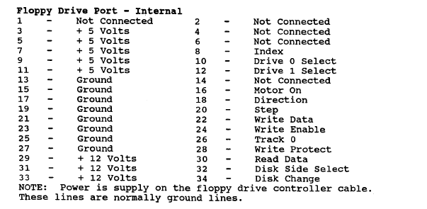

Do you have the floppy pinout of this computer ?
EDIT :
Found it. It seems that tandy have put +12V & +5V power supply lines on the floppy cable.
http://vintage-blog.peacon.co.uk/downlo ... -vol-1.pdf
You need to cut wires 3,5,7,9,11,29,31 and 33 on the floppy cable before pluging the HxC (or any standard floppy disk drive).
The "computer don't start" is probably the right cable way, but you need to cut these lines to avoid shortcut...
Please note that you have probably damaged some lines of the HxC with the +12V voltage...
Hopefully you have just to change the 74LS38 chip...
So be careful with this computer ! It is dangerous ;)
EDIT :
Lucky I only tried it once.. I will have to make my own cable then I guess.. The HxC is ok, just tried it on Amiga 500 , TRS-80 and PC works good.
