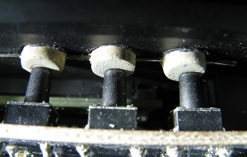

Btw. I have a question... I suppose the buttons are supposed to be fitted with some caps of some kind, am I right? What kind of caps am I supposed to look for? I'd love to close the front side of what once was the floppy drive with a faceplate with only a small hole for the SD card, and have the buttons sick out on top, but I would need some kind of long caps that fit on the buttons...

the problem is this: the hxC has 3 buttons soldered on the board. These buttons onlz have small "knobs" to be pushed. now, I have mounted the hxC inside the Dss-1, so that the frontside of the pcb is flush with what once was the floppy drive frontpanel (I did it like the guy on this page: http://www.burncards.com).
Now, I'd like the buttons to stick out from top, because I'd like to close the open hole with a frontplate, to prevent dust to get in. My plan is to drill 3 hole on the upper side of the plastic that covers the floppy drive compartment on the Dss-1 and have 3 botton caps that work as an extension of the actual caps that are on the buttons... I just don't know if I'll have to make such caps myself or if I can find these around...

http://www.selectronic.fr/article.asp?a ... =11.3709-1

I used eraser rubbers I had here to use as caps/knobs, have a look below.
I put a needle across all of them to keep them away from falling out, it works as expected.

Thanks a lot! Not sure I will be able to find those button caps... but I might try the rubber trick!
