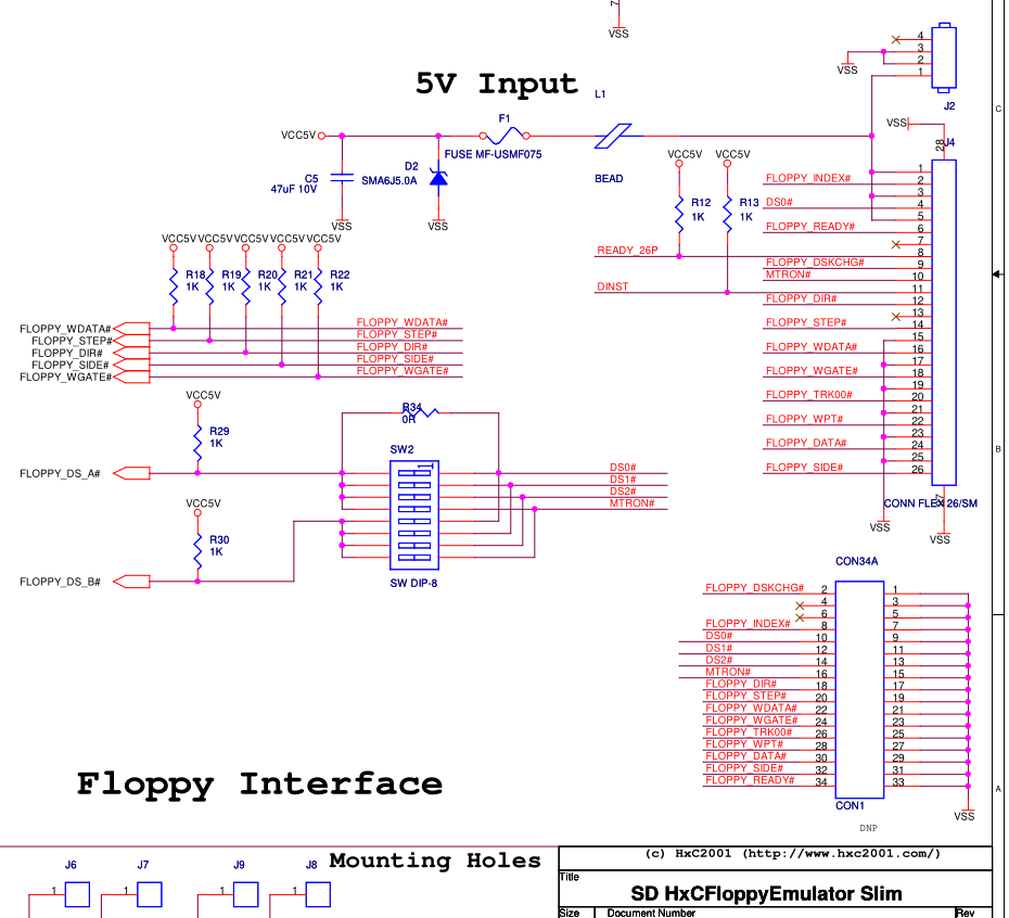

the pin 6 "DISK CHANGE" match with the pin 34 ibm pc pin.
this is connected this way in the slim hxc :
https://hxc2001.com/download/floppy_dri ... Design.zip

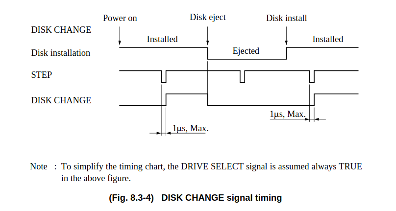

You should have this behavior on this pin :
https://bitsavers.org/pdf/teac/FD-05HF-8830.pdf
Screenshot at 2025-05-09 11-53-30.png (33.33 KiB) Viewed 57090 times
Note : When the drive selection is high the diskchange signal should be high too !
Note 2 : Low = something near 0v, High = Something around 5V.
Is it the case with your setup ?

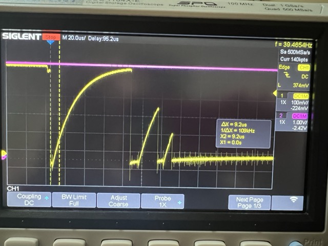

Post by steve_atx »

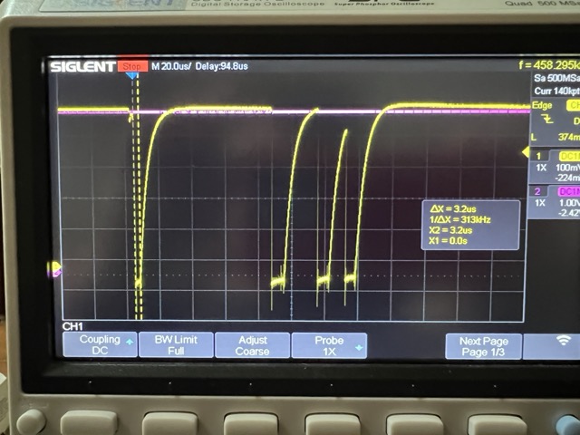

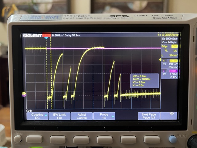

Finally got around to checking this pin 6 "DISK CHANGE" ( 34 ibm pc pin) the yellow trace. The "STEP" is the magenta trace. When I insert or change the disk there isn't any change on DISC CHANGE (stays high) unless I push a button on the machine to read the disk. Then 4 to 6 low going pulses appear on "DISK CHANGE" depending on the resistor pull-up value. They won't appear unless a pull-up resistor is used. The last pulse will eventually stay at ground if a large enough resistor pull-up is used. Guessing that if the last in the series of three low going pulses can't return to a high enough voltage the drive will driving "DISK CHANGE" low on the last pulse. I'm not sure what's going on but with 470K the disk change feature now works for me. Finally with the 470K pull-up in place after enough time when the "STEP" pulse goes low the "DISK CHANGE" is released and pulls back up to VDD. With 220K it seems to pull-high through another mechanism.
Another issue I had was to get write-protect to sense both states I needed a 100K pull-up.
Here are the list of resistors now. Pretty sure I need all of these....
6 DISK CHANGE/FLOPPY_READY# (needs 470K - R4 to VDD)
9 HD OUT (HD at HIGH level)/FLOPPY_DSKCHG# (needs 1K - R9 to VDD)
22 WRITE PROTECT/FLOPPY_WPT# (needs 100K to VDD)
24 READ DATA/FLOPPY_DATA# (needs 1K - R8 to VDD)

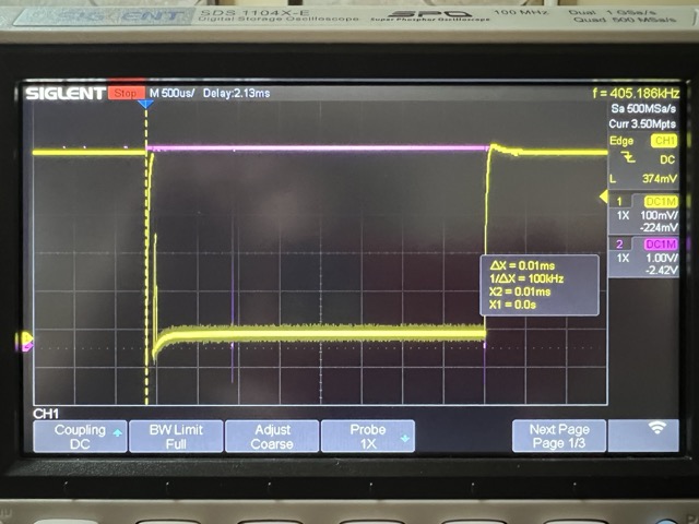

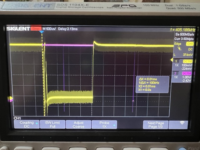

The longer time waveforms:

Everything is working properly now, write protect and disk change. K is for kiloohm. So 470K is 470000 ohm. I’m not sure why my waveforms for disk change are so different than the teac spec waveform you sent and I have only a theory why the disk change is working now with the 470K pull-up. If you have any idea let me know.
