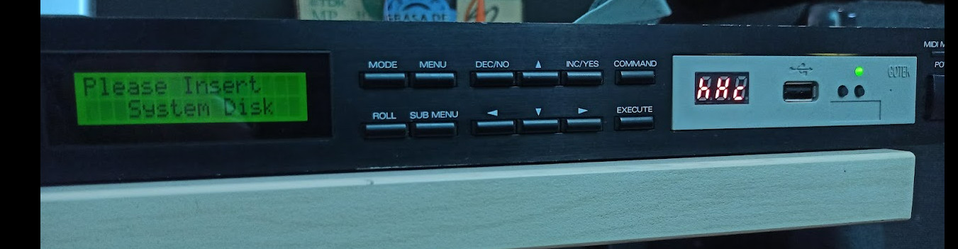

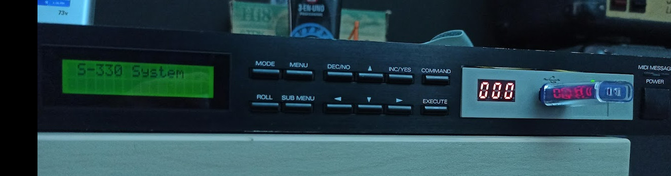

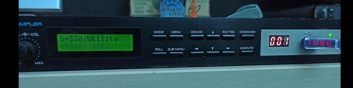

I'm installing an HXC on a Roland S-330.
The HXC is installed on the Gotek, and the pen have the quit files That I pick up from HXC site for Roland S-330
The S-330 see the files but don't start!! Stop after the drive read the file!!
What I am doing wrong?
Is the ff.cfg wrong?
Regards.
Goncalo
Re: Roland S-330 with Gotek HXC -- HELP
Nothing is wrong on these pictures, the drive appears to work fine since you booted the S330 on the images.
You just need to add and select an data disk image.
