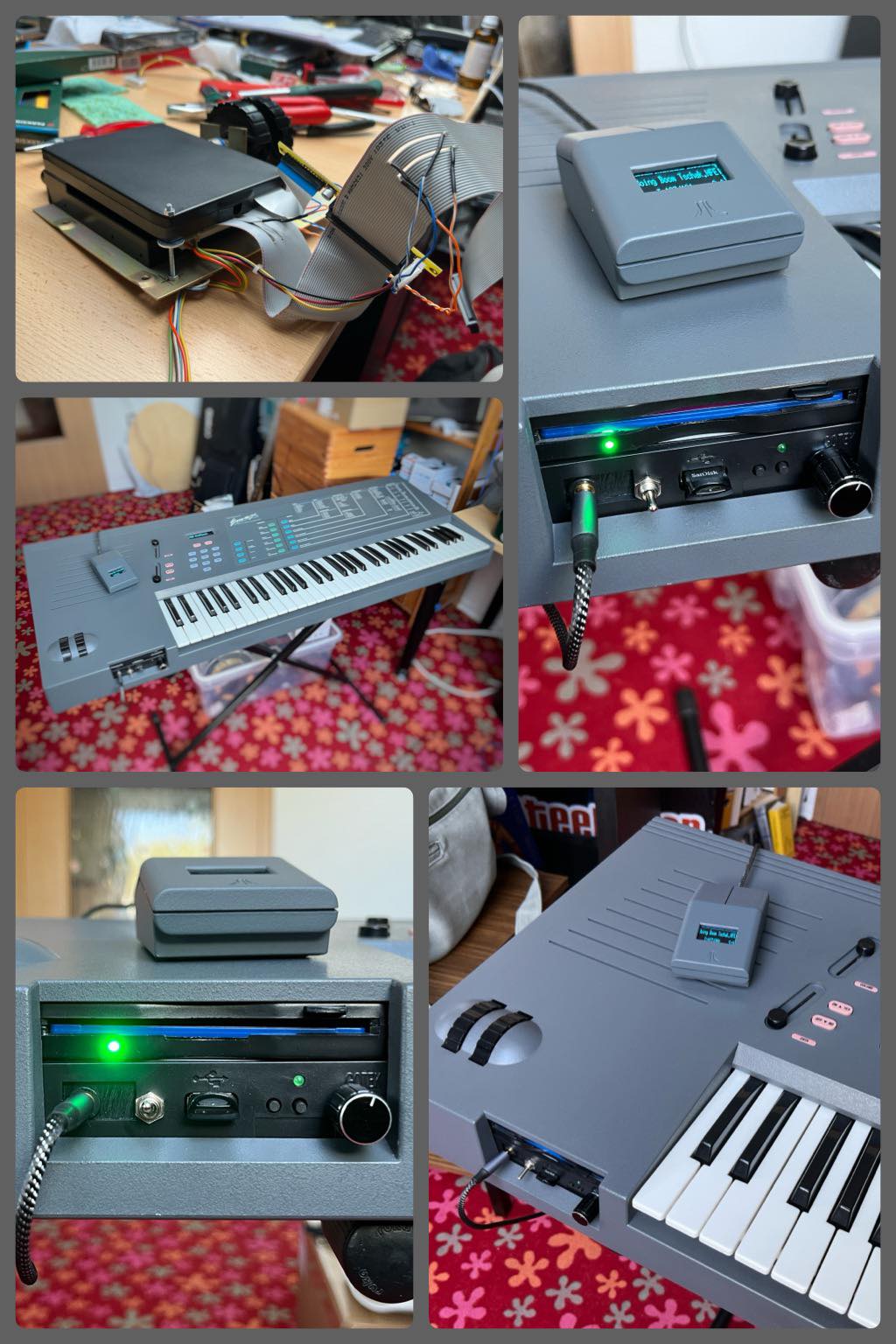

I‘ve got some news for you. :D
My Emax now works with two drives - the Gotek USB-Floppy-Emulator und a Slim-Floppydrive. With a small DPDT-switch, I can choose between the two drives. The 2-contact-switch switches the „Drive-Select-0“ (Shugart Pin 10) and the „Motor-On“ (Shugart Pin 16) to either the Gotek or the slim floppy drive. It works perfectly. Now I can use the floppy disks again.
Happy eastern to all Emax-users. :D
Regards
Heiko
