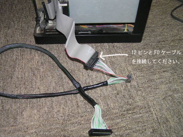

At present, I see that Japanese players have a very funny solution:
Please refer to this website (Japanese):
https://gra4.hatenadiary.jp/entry/20171119/1511085342
The general meaning is that through a fork, the special signal line will continue to be connected to the original floppy drive, while the rest of the general part will be connected to hxc, and use a floppy disk to deceive the computer.
It's stupid, but it works

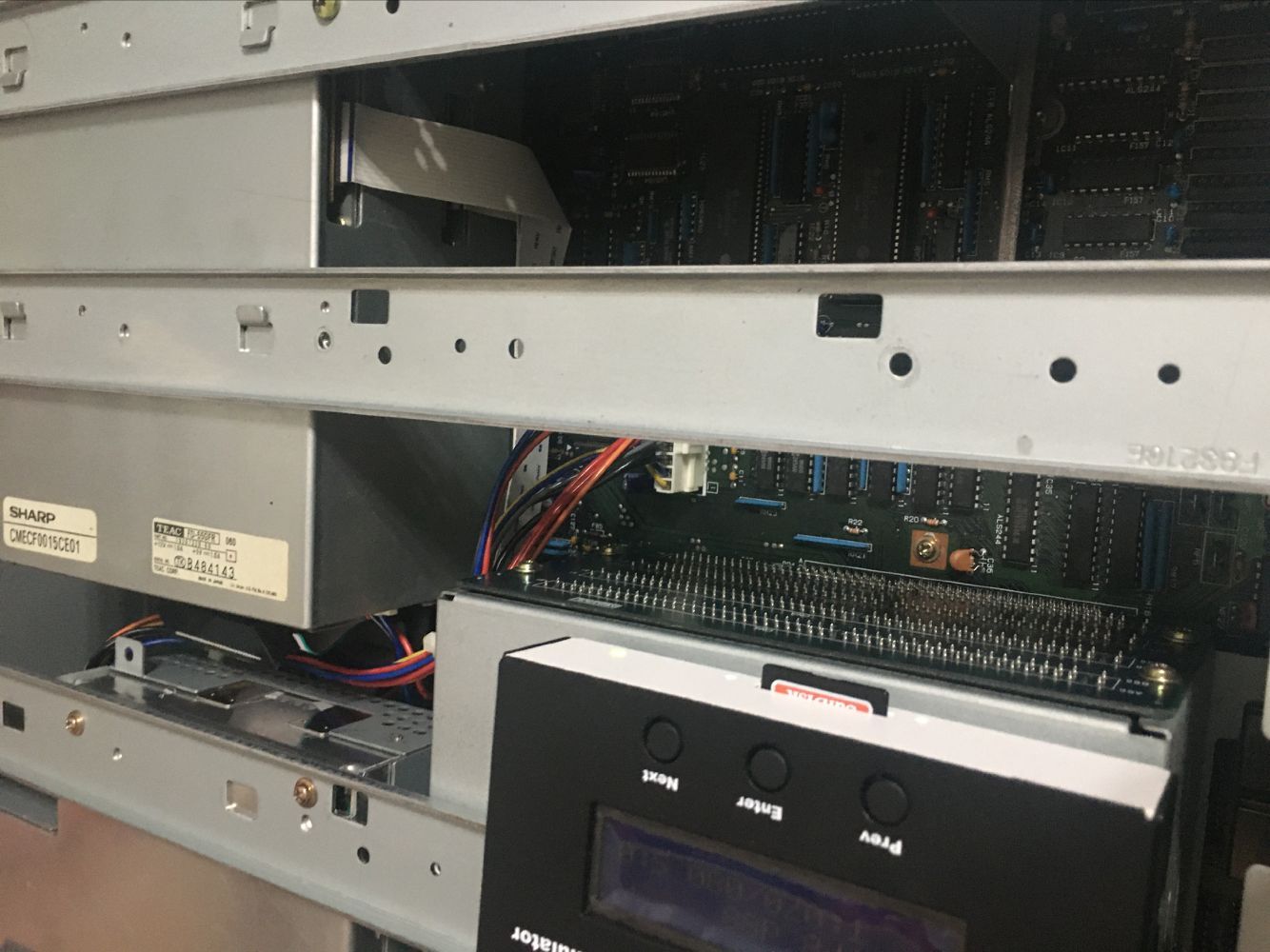

At present, I found that the X68000 Pro model can easily use hxc. Just unplug all edge interfaces of the physical floppy drive, then connect hxc to the external floppy drive interface and adjust to the dual drive mode.
This method comes from a researcher at Yahoo auction in Japan. He sold me a set of self-made connecting cables for external floppy drives, which is mentioned in the attached DVD.
Because the ribbon of the X68000 Pro floppy drive is separated, the special signal is connected by a ribbon (the white ribbon in the photo), and the ribbon of the data part is the same as that of the ordinary floppy drive. As long as the special signal ribbon is connected and the ribbon of the data part is disconnected, and an arbitrary floppy disk is inserted in each floppy drive to "cheat" the floppy drive for special signal identification, In this way, this will exchange data with hxc and X68000
But the ordinary x68000 (tower) is more troublesome. It has only a special 12 pin ribbon plug. All signals are mixed together. We must separate the parts of special signals by the method I mentioned earlier.
At present, I have successfully run most games in this way, but when changing the disk, the floppy disk used for "cheating" will pop up and need to be inserted manually

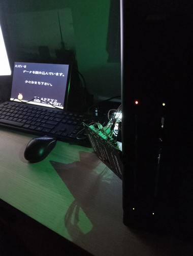

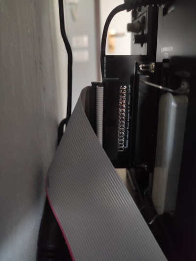

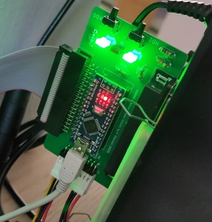

I think may be useful for update this topic the link to my open source solution for use HxC as external drive with X68000:
https://github.com/aotta/X68KFDUINO
it works with most games i tested since now (except for Tunnels&Trolls), it's cheap to build and open source, so anyone could improve it.

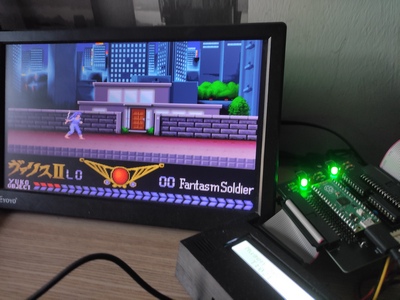

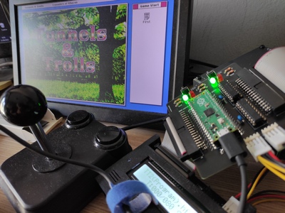

i made a new version, based with Raspberry Pico, that works fine now with all games i tested so far, and use red leds and blinking mode:
https://github.com/aotta/X68KFDPi

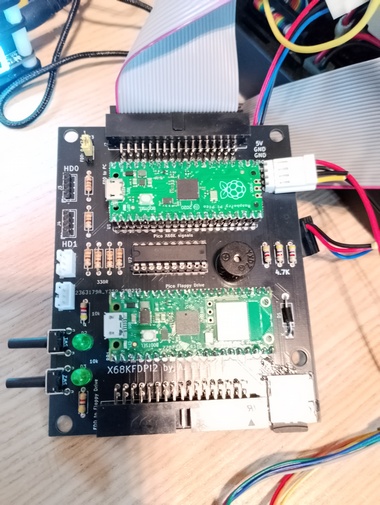

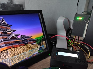

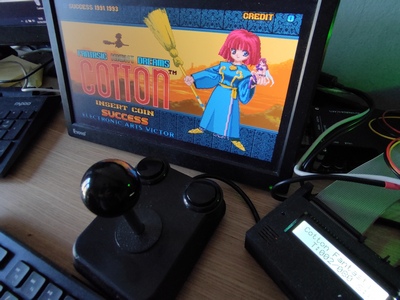

I built a new open source floppy emulator "All-in-on" with support for HDM and HFE images and it emulates both drive 0 and 1.
Only reading floppies images for now, but enough for most games.
Here's the projects and source files:
https://github.com/aotta/X68KFDPi2W
