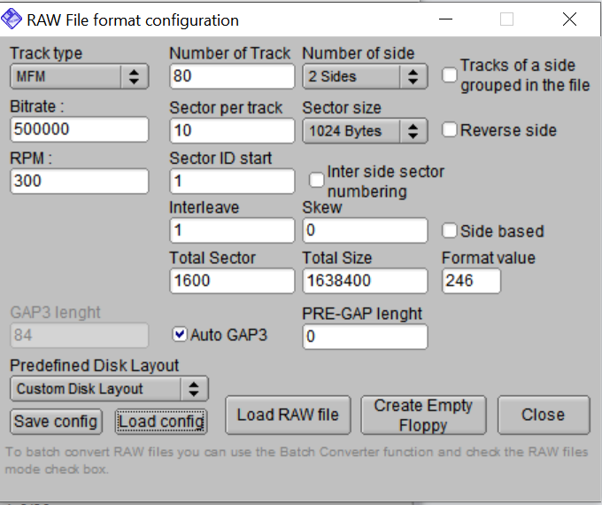

I tried to open the working disk image I bought with the software, and it seems to load fine in the main UI and the scrolling message tells me it's 80 tracks 2 sides (this differs from the 84 tracks that some tutorials pointed me to). I found this thread: viewtopic.php?f=28&t=710 which also indicated 80 sides is the correct value. However, if I set these custom settings:
and then click on 'Disk Browser', as shown in the youtube video, I get a red error message at the bottom of the disk browser - "Null sized DOS image ! Invalid disk !". This means I can't drag any wav samples in, and I'm stuck. Similarly, if I try to use the disk browser having loaded the working image I bought, I get the same message.

* In HxCFloppyEmulator click 'Load Raw Image" and pick "Akai S3000 3.5 HDD floppy disk" from the "predefined disk layout" dropdown (can't believe I didn't spot this before!)
* Click "Load Raw File" and navigate to the .img file that you have written a sample to
* "Floppy Image" -> "Export Disk / Save as" -> give a filename, this makes a .hfe image which should be 3921KB
