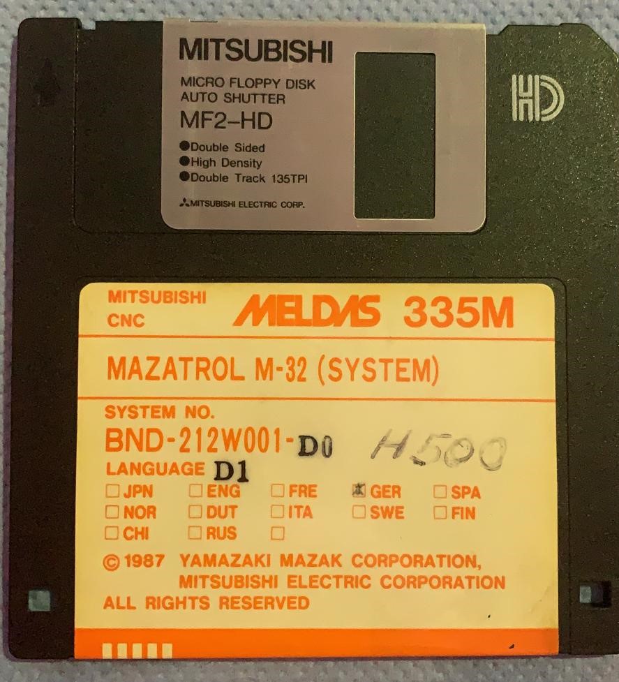

Hello everybody,
am currently working on the same assignment as tuan pavn. Would like to use a GOTEK USB drive for it. But I still have no idea how to configure HxC2001 so that the machine boots from it.
Can easily image the floppy disk and clone it onto new disks. Do I have to use the image less method for this? And how do I get the image on the stick so that I can start right away?
I can share the Floppy Image if needed
Thanks and sorry for my google translator english :roll:
