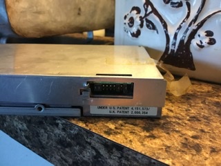

Here are the jumpers on floppy A. Jumpers at 1,3,8, and 9 or 1,2,7, and 9 depending if you count left to right or right to left.
