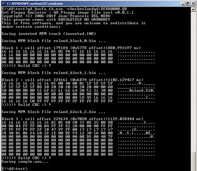

fyi all disks images are valid : the tracks are ok and the CRCs are valid... :

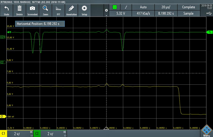

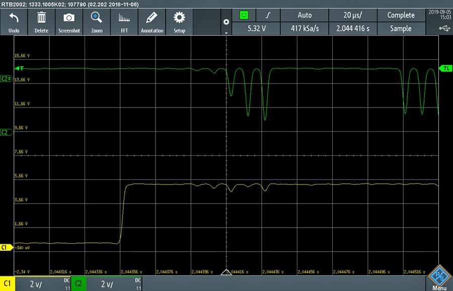

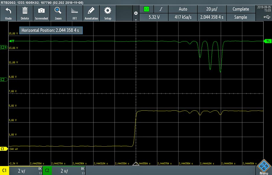

Can take some new traces ? :
I need these following screens with the Write gate and the write data line :
-> at the first Write gate rising edge (edge centered on the screen @ ~20uS/div)
-> at a "glitch" Write gate falling edge (edge on the left on the screen @ ~100uS/div) (the whole glitch should fit the screen)
-> at a "glitch" Write gate falling edge (edge centered on the screen @ ~20uS/div)
-> at a "glitch" Write gate rising edge (edge centered on the screen @ ~20uS/div)
-> at the last Write gate falling edge (edge centered on the screen @ ~20uS/div)
What i want to check is the write data pulses spacing under the write gate glitches and at the write start and end.

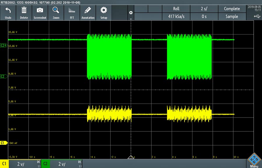

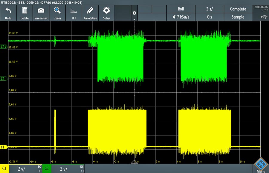

That is good news...now the traces
Write & Read.jpg (96.42 KiB) Viewed 223698 times

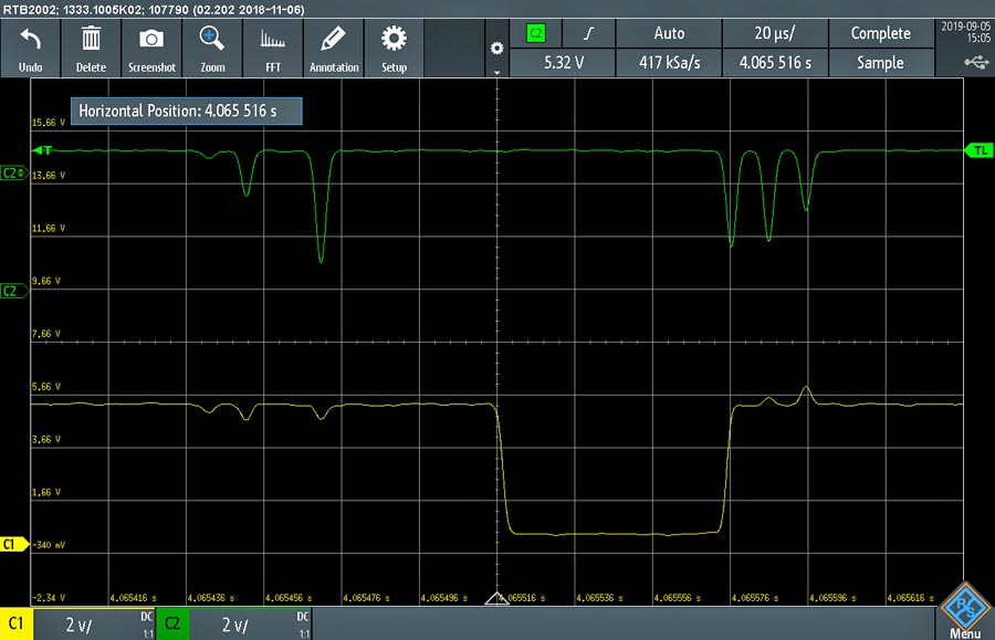

Write Data & Write Gate (Start1).jpg (86.81 KiB) Viewed 223698 times
Write Data & Write Gate (Start).jpg (88.34 KiB) Viewed 223698 times

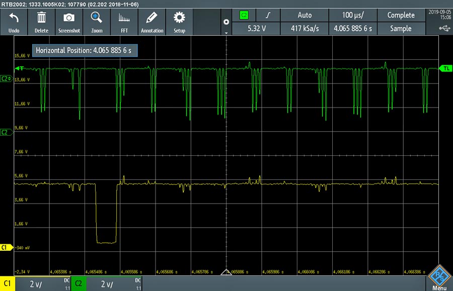

traaces
Write Data & Write Gate (Glitch 1 Detail).jpg (89.04 KiB) Viewed 223698 times
Write Data & Write Gate (Glitch 1).jpg (97.42 KiB) Viewed 223698 times

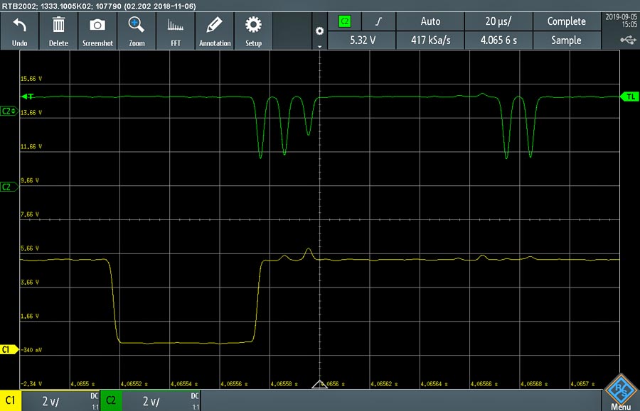

traces
Write Data & Write Gate (Glitch 1 Detail Again).jpg (86.33 KiB) Viewed 223698 times
Write Data & Write Gate (End of Write Cycle 1).jpg (87.7 KiB) Viewed 223698 times

Re: 2.8" QD Disk Emulation
AMSynths wrote: Thu Sep 05, 2019 4:24 pm Its the verify read back that's failing here.
First activity is the Check QD, then the Write and then the read verify -which fails at the end
Thanks !
The oscilloscope sampling rate is too low to be able to decode the write data line. Could you increase it at 5MSa/s when you are at 100uS/20uS per div ?
Anyway the write gate glitches duration appears to match to the blank recorded in the .QD files, so i think that this part is working properly in the current firmware.
Is the the Motor On line always during the write/verify cycle ?
I am now unsure what cause this "verify error" while you can read back the disk right after.
Btw why the Roland QD drive appears to have a 4.5s ready window while the MO5 and Akai QD drives have a 5.4s window ? I though that Roland and Akai machines shared the same QD drive ? Maybe the issue is just related to some ready window/read duration timing miss-configuration.
What is the Roland QD drive whole read/turn duration and ready window duration (at the millisecond level) ?
The HxC Gotek firmware have been tested on a MD-280 / Akai 612 : This works "out-the-box". :D
I have added the Akai QD format to the HxC QuickDisk toolkit software :
https://github.com/jfdelnero/HXCFE_QuickDisk_Toolkit
You can currently convert your Akai QD disk image to wav. I can easily add the wav->Quickdisk image converter too if you are interested by this feature.
