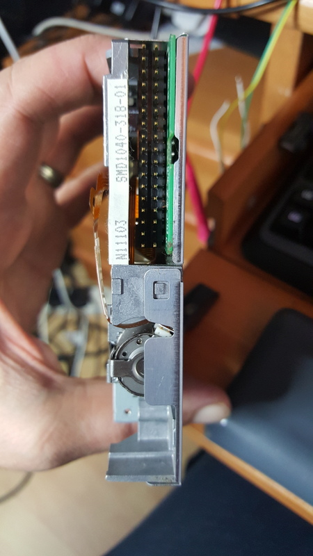

I have an old (1980's) HP 1661A Logic Analyser (its part of the HP 1660 series) of Logic Analysers and I was hoping to swap out the Floppy Drive.
I'm using a flashed HxC Gotek drive.

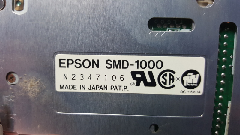

The floppy is an Epson SMD 1000 (SMD 1040-318-01, N11103). The analyser can format and write standard MSDOS 3.25" DSDD floppies and I can read
them on my Windows 7 PC's USB floppy drive fine.
This SMD1000 drive model however, does not have a 4 pin power connector at all, just the standard 34-pin IDC connector.
I probed all 34 pins and the pinout seems to be very different to a normal connector (See my results below).
Looking through these forums and the list of supported drives I can see that the SMD 1000 is supported on the 'GEM WX-Expander', however that SMD1000
unit does have the 4 pin power connector. As the power supplied to the drive appears to be very different to normal, I have not connected up the emulator as yet.
My question is can I just connect up the emulator or will I need different firmware?
There is an 8 pin jumper block on the top of the drives motherboard, with most pins jumpered. Again not in a conventional manner either.
I can post pics but given someone has probably done this already I was hoping that someone could help me out.
I would like to avoid 'magic smoke' coming from anything :)

Pinout (34-pin IDC connector)
Pin
1
3
5
7 5v
9 5v
11 5v
13 Ground
15 Ground
17 Ground
19 Ground
21 Ground
23 Ground
25 Ground
27 Ground
29 Ground
31 Ground
33 Ground
Pin
2 5v
4 5v
6
8 5v
10
12
14
16
18
20
22
24
26 5v
28 5v
30 5v
32
34 5v

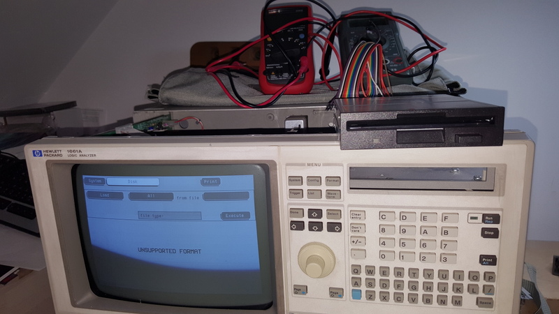

Okay so as I've had no replies so I dug out an old 3.25 PC drive in order to see if I could get the HP Logic Analyser to
recognise that as a first step. I also found this article where someone (davorin) had managed to get another HP Logic Analyser the 16500A working with a PC floppy.
http://www.eevblog.com/forum/testgear/h ... b-upgrade/

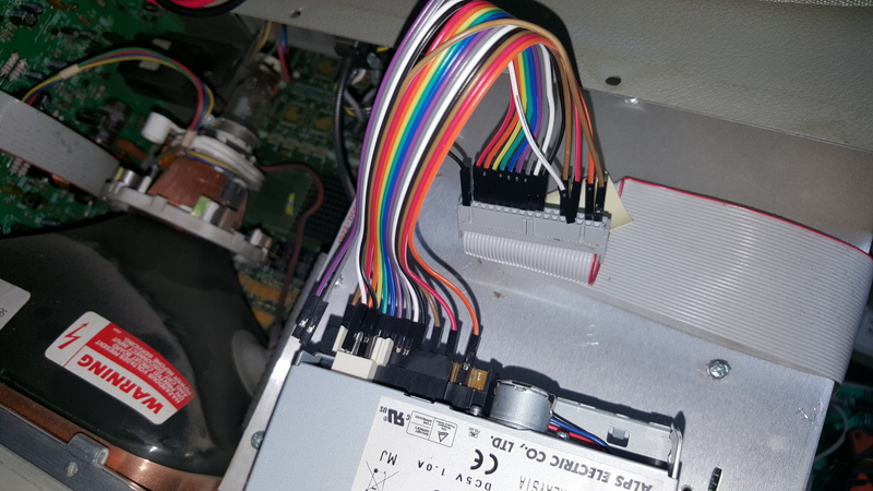

I believe the pinout is almost fully Shugart so I followed his wiring and jumpered the drive in as follows:
Drive connections to PC floppy drive.
Power
7, +5V Connected to 5v connection on PC floppy 4 pin power connector
9 - +5V but not connected
11 - +5V but not connected
13, 15, 17, 19, 21, 23, 25, 27, 29, 31, 33 - GND, I've connected pin 33 to Ground on the 4 pin power connector
Analyser cable - PC floppy drive:
2 - Connected to pin 34
4 - 4 /BUSY
6 - open
8 - 8 /INDEX
10 - 12 /DRIVE1
12 - open
14 - open
16 - 16 /MOTOR1
18 - 18 /DIR
20 - 20 /STEP
22 - 22 /WDATA
24 - 24 /WGATE
26 - 26 /TRK00
28 - 28 /WPT
30 - 30 /RDATA
32 - 32 /SIDE1
Same as him the PC floppy now powers on at boot up, the LED illuminates and I can hear the heads seeking but the Analyser will not read the disk.
It just says 'Unsupported Format' on screen and fails it startup test, but at least I have no 'magic smoke' coming from the drive.
Unfortunately I'm a floppy disk noob so I'm not sure what to try next :(
Any ideas anyone ?
