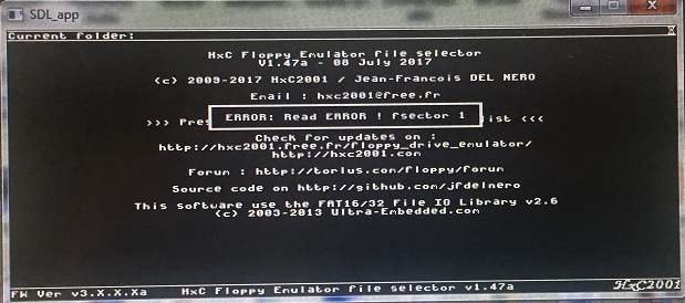

ERROR: Read ERROR ! fsector 1
sonicthewedge
Posts: 11
Joined: Mon Jul 23, 2018 7:14 am
Post by sonicthewedge »
I have created a rather elaborate set up to allow me to access my Gotek drive via my network.
It involves a Raspberry Pi Zero W configured as a FAT32 USB gadget and a modified USB cable plugged into the Gotek. I can access the Zero's SMB mounted drive over the network without any issues. All works well with the Gotek drive itself too.
However, when I plug the USB into a PC, the Zero is recognised as a USB removable disk by Windows (though it does suggest that I scan the disk which I have attempted with the usual fruitless result) but I get a, "ERROR: Read ERROR ! fsector 1" error when I try to use SDL_app, HxC Floppy Emulator file selector to, "<- Get List".
I was hoping to administer the drive via my PC for assorted convenience reasons. Does anyone have any suggestions on how to resolved this?
I hope this makes some sense and if anyone is interested in doing something similar, I will gladly share the details.
Ed

Regarding your issue are you executing the manager tool as administrator ? (btw this manager seems outdated)

Thanks for your response.
Yeah, I am executing the manager and the GUI as administrator. I set it in preferences for each executable too and tried different compatibility modes without success - I am using Windows 7.
What is the latest Manager version and where can I get it? I was confident that I had checked all the links and downloaded the latest version as part of my RCA.
Thanks again.

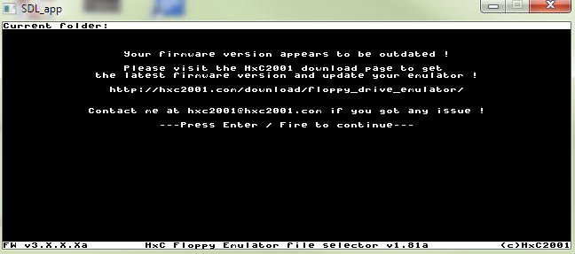

So, I have had intermittent success.
I have updated everything I can find to what I think are the latest versions.
HxC Floppy Emulator file selector v1.81a and I can get FF-HxC_Editor v0.51 to occasionally write some get / set files.
I still get this from the command line (administrator mode):
I am not exactly sure where the "firmware" is that it is referring to. Is this the two files AUTOBOOT.HFE and HXCSDFE.CFG in the root of my F: USB drive?
I think I installed this on my Gotek: HXCFEUSB_V3_1_23_1a.UPD
I got my firmware from here: https://hxc2001.com/download/floppy_dri ... rmware.zip
I have been using:
%path%\HXCFEMNG.exe -disk:F: -getslots:%path%\hx_getlisted.txt -verbose
%path%\HXCFEMNG.exe -disk:F: -setslots:%path%\hx_setlist.txt -verbose
%path%\HXCFEMNG.exe -disk:F: -verbose

Oddly, I can now get FF-HxC_Editor to write to the HXCSDFE.CFG file but not read. I still can't get the command line to mount / set / get from the USB drive at all. I still get the, "Your firmware version appears to be outdated !" error even though I am using the AUTOBOOT.HFE
15 July 2018: Firmware STM32 USB HxCFloppyEmulator v3.1.26.5a ( -> In the "Next_WIP_Alpha_Firmware_And_Tools" Folder !)
Re: ERROR: Read ERROR ! fsector 1
sonicthewedge wrote: Tue Jul 24, 2018 12:22 pm Oddly, I can now get FF-HxC_Editor to write to the HXCSDFE.CFG file but not read. I still can't get the command line to mount / set / get from the USB drive at all. I still get the, "Your firmware version appears to be outdated !" error even though I am using the AUTOBOOT.HFE
please ignore this warning.
Try this version:
https://hxc2001.com/vrac/hxcfemng_win32.zip
i have enabled the debug output. Copy past the debug output here.

Firmware not supporting this config file !
UIOut x:-16 y:10 ERROR: Bad Config File version !
sonicthewedge
Posts: 11
HXCFEMNG.exe -disk:F: > output.txt
This version loads up the file selector.

UIOut x:41 y:5 (c) 2009-2018 HxC2001 / Jean-Francois DEL NERO
Email :
>>> Press HELP key for the function key list <<<
Updates: https://hxc2001.com/floppy_drive_emulator/
https://hxc2001.com
Forum: http://hxc2001.com/floppy/forum
Facebook: https://www.facebook.com/groups/hxc2001
Sources : http://github.com/jfdelnero
This software uses the FAT16/32 File IO Library v2.6
(c) 2003-2013 Ultra-Embedded.com
UIOut x:64 y:6
Email :
https://hxc2001.com
UIOut x:52 y:7 Email :
https://hxc2001.com
UIOut x:64 y:8
https://hxc2001.com
UIOut x:40 y:9 >>> Press HELP key for the function key list <<<
https://hxc2001.com
UIOut x:36 y:10 Updates: https://hxc2001.com/floppy_drive_emulator/
https://hxc2001.com
UIOut x:36 y:11 https://hxc2001.com
UIOut x:36 y:12 Forum: http://hxc2001.com/floppy/forum
UIOut x:36 y:13 Facebook: https://www.facebook.com/groups/hxc2001
UIOut x:36 y:14 Sources : http://github.com/jfdelnero
UIOut x:64 y:15
UIOut x:38 y:16 This software uses the FAT16/32 File IO Library v2.6
UIOut x:48 y:17 (c) 2003-2013 Ultra-Embedded.com
Init display Done
init_fdc Done
media_init
UIOut x:0 y:95 FW v3.X.X.Xa
setlbabase : 0x00000002
test_floppy_if : 00000002 = 00000002 ?
setlbabase : 0x00000001
test_floppy_if : 00000001 = 00000001 ?
setlbabase : 0x00000000
media_init : HxC FE Found
media_init done
fl_init done
media_read sector : 0x00000000, cnt : 1
UIOut x:632 y:1
0 1 2 3 4 5 6 7 8 9 A B C D E F
0000 : EB 58 90 6D 6B 66 73 2E 66 61 74 00 02 20 20 00 .X.mkfs.fat.. .
0010 : 02 00 00 00 00 F8 00 00 3F 00 FF 00 00 00 00 00 ........?.......
0020 : 00 00 00 04 00 40 00 00 00 00 00 00 02 00 00 00 .....@..........
0030 : 01 00 06 00 00 00 00 00 00 00 00 00 00 00 00 00 ................
0040 : 80 01 29 7A 6A 56 D7 4E 4F 20 4E 41 4D 45 20 20 ..)zjV.NO NAME
0050 : 20 20 46 41 54 33 32 20 20 20 0E 1F BE 77 7C AC FAT32 ...w|.
0060 : 22 C0 74 0B 56 B4 0E BB 07 00 CD 10 5E EB F0 32 ".t.V.......^..2
0070 : E4 CD 16 CD 19 EB FE 54 68 69 73 20 69 73 20 6E .......This is n
0080 : 6F 74 20 61 20 62 6F 6F 74 61 62 6C 65 20 64 69 ot a bootable di
0090 : 73 6B 2E 20 20 50 6C 65 61 73 65 20 69 6E 73 65 sk. Please inse
00A0 : 72 74 20 61 20 62 6F 6F 74 61 62 6C 65 20 66 6C rt a bootable fl
00B0 : 6F 70 70 79 20 61 6E 64 0D 0A 70 72 65 73 73 20 oppy and..press
00C0 : 61 6E 79 20 6B 65 79 20 74 6F 20 74 72 79 20 61 any key to try a
00D0 : 67 61 69 6E 20 2E 2E 2E 20 0D 0A 00 00 00 00 00 gain ... .......
00E0 : 00 00 00 00 00 00 00 00 00 00 00 00 00 00 00 00 ................
00F0 : 00 00 00 00 00 00 00 00 00 00 00 00 00 00 00 00 ................
0100 : 00 00 00 00 00 00 00 00 00 00 00 00 00 00 00 00 ................
0110 : 00 00 00 00 00 00 00 00 00 00 00 00 00 00 00 00 ................
0120 : 00 00 00 00 00 00 00 00 00 00 00 00 00 00 00 00 ................
0130 : 00 00 00 00 00 00 00 00 00 00 00 00 00 00 00 00 ................
0140 : 00 00 00 00 00 00 00 00 00 00 00 00 00 00 00 00 ................
0150 : 00 00 00 00 00 00 00 00 00 00 00 00 00 00 00 00 ................
0160 : 00 00 00 00 00 00 00 00 00 00 00 00 00 00 00 00 ................
0170 : 00 00 00 00 00 00 00 00 00 00 00 00 00 00 00 00 ................
0180 : 00 00 00 00 00 00 00 00 00 00 00 00 00 00 00 00 ................
0190 : 00 00 00 00 00 00 00 00 00 00 00 00 00 00 00 00 ................
01A0 : 00 00 00 00 00 00 00 00 00 00 00 00 00 00 00 00 ................
01B0 : 00 00 00 00 00 00 00 00 00 00 00 00 00 00 00 00 ................
01C0 : 00 00 00 00 00 00 00 00 00 00 00 00 00 00 00 00 ................
01D0 : 00 00 00 00 00 00 00 00 00 00 00 00 00 00 00 00 ................
01E0 : 00 00 00 00 00 00 00 00 00 00 00 00 00 00 00 00 ................
01F0 : 00 00 00 00 00 00 00 00 00 00 00 00 00 00 55 AA ..............U.
UIOut x:632 y:1
UIOut x:632 y:1
UIOut x:632 y:1
fl_attach_media done
UIOut x:52 y:10 Reading HXCSDFE.CFG ...
enter read_cfg_file
media_read sector : 0x00008020, cnt : 1
UIOut x:632 y:1
setlbabase : 0x00008020
0000 : 42 67 00 00 00 FF FF FF FF FF FF 0F 00 80 FF FF Bg..............
0010 : FF FF FF FF FF FF FF FF FF FF 00 00 FF FF FF FF ................
0020 : 01 44 00 65 00 66 00 61 00 75 00 0F 00 80 6C 00 .D.e.f.a.u....l.
0030 : 74 00 20 00 43 00 6F 00 6E 00 00 00 66 00 69 00 t. .C.o.n...f.i.
0040 : 44 45 46 41 55 4C 7E 32 20 20 20 10 00 00 7B 24 DEFAUL~2 ...{$
0050 : F2 4C F2 4C 07 00 7B 24 F2 4C BA A8 00 00 00 00 .L.L..{$.L......
0060 : 41 41 00 70 00 70 00 6C 00 69 00 0F 00 CE 63 00 AA.p.p.l.i....c.
0070 : 61 00 74 00 69 00 6F 00 6E 00 00 00 73 00 00 00 a.t.i.o.n...s...
0080 : 41 50 50 4C 49 43 7E 31 20 20 20 10 00 64 62 1F APPLIC~1 ..db.
0090 : F2 4C F2 4C 00 00 62 1F F2 4C AA 08 00 00 00 00 .L.L..b..L......
00A0 : 41 44 00 65 00 6D 00 6F 00 73 00 0F 00 AA 00 00 AD.e.m.o.s......
00B0 : FF FF FF FF FF FF FF FF FF FF 00 00 FF FF FF FF ................
00C0 : 44 45 4D 4F 53 20 20 20 20 20 20 10 00 64 64 24 DEMOS ..dd$
00D0 : F2 4C F2 4C 03 00 64 24 F2 4C CB B4 00 00 00 00 .L.L..d$.L......
00E0 : 41 47 00 61 00 6D 00 65 00 73 00 0F 00 D4 00 00 AG.a.m.e.s......
00F0 : FF FF FF FF FF FF FF FF FF FF 00 00 FF FF FF FF ................
0100 : 47 41 4D 45 53 20 20 20 20 20 20 10 00 64 1B 48 GAMES ..d.H
0110 : F1 4C F1 4C 03 00 1B 48 F1 4C 90 BA 00 00 00 00 .L.L...H.L......
0120 : E5 4E 00 65 00 77 00 20 00 66 00 0F 00 DD 6F 00 .N.e.w. .f....o.
0130 : 6C 00 64 00 65 00 72 00 00 00 00 00 FF FF FF FF l.d.e.r.........
0140 : E5 45 57 46 4F 4C 7E 31 20 20 20 10 00 64 CC 2A .EWFOL~1 ..d.*
0150 : F8 4C F8 4C 00 00 CC 2A F8 4C 8B 00 00 00 00 00 .L.L...*.L......
0160 : E5 58 43 53 44 46 45 20 43 46 47 20 00 00 1B 20 .XCSDFE CFG ...
0170 : F2 4C F2 4C 07 00 72 80 7D 47 A5 56 00 A0 00 00 .L.L..r.}G.V....
0180 : 41 57 00 6F 00 72 00 6B 00 62 00 0F 00 BD 65 00 AW.o.r.k.b....e.
0190 : 6E 00 63 00 68 00 00 00 FF FF 00 00 FF FF FF FF n.c.h...........
01A0 : 57 4F 52 4B 42 45 7E 31 20 20 20 10 00 64 C5 4D WORKBE~1 ..d.M
01B0 : F2 4C F2 4C 00 00 C5 4D F2 4C C7 04 00 00 00 00 .L.L...M.L......
01C0 : 41 53 00 74 00 6F 00 72 00 61 00 0F 00 99 67 00 AS.t.o.r.a....g.
01D0 : 65 00 00 00 FF FF FF FF FF FF 00 00 FF FF FF FF e...............
01E0 : 53 54 4F 52 41 47 45 20 20 20 20 10 00 00 16 1C STORAGE .....
01F0 : F2 4C F2 4C 07 00 16 1C F2 4C D3 55 00 00 00 00 .L.L.....L.U....
UIOut x:632 y:1
media_read sector : 0x00008021, cnt : 1
UIOut x:632 y:1
0000 : 41 41 00 6D 00 69 00 67 00 61 00 0F 00 4B 20 00 AA.m.i.g.a...K .
0010 : 46 00 6F 00 72 00 6D 00 61 00 00 00 74 00 00 00 F.o.r.m.a...t...
0020 : 41 4D 49 47 41 46 7E 31 20 20 20 10 00 64 C7 24 AMIGAF~1 ..d.$
0030 : F2 4C F2 4C 07 00 E9 25 F2 4C 50 56 00 00 00 00 .L.L...%.LPV....
0040 : 41 4B 00 69 00 63 00 6B 00 73 00 0F 00 6F 74 00 AK.i.c.k.s...ot.
0050 : 61 00 72 00 74 00 00 00 FF FF 00 00 FF FF FF FF a.r.t...........
0060 : 4B 49 43 4B 53 54 7E 31 20 20 20 10 00 64 EE 2A KICKST~1 ..d.*
0070 : F8 4C F8 4C 00 00 F4 2A F8 4C 8B 00 00 00 00 00 .L.L...*.L......
0080 : E5 45 46 41 55 4C 7E 31 20 20 20 10 00 00 6E 24 .EFAUL~1 ...n$
0090 : F2 4C F2 4C 00 00 6E 24 F2 4C 00 00 00 00 00 00 .L.L..n$.L......
00A0 : E5 2E 00 54 00 58 00 54 00 00 00 0F 00 6B FF FF ...T.X.T.....k..
00C0 : E5 52 00 45 00 41 00 44 00 4D 00 0F 00 6B 45 00 .R.E.A.D.M...kE.
00D0 : 20 00 2D 00 20 00 43 00 6F 00 00 00 70 00 79 00 .-. .C.o...p.y.
00E0 : E5 45 41 44 4D 45 7E 31 54 58 54 20 00 1C EC A2 .EADME~1TXT ....
00F0 : F1 4C F1 4C 00 00 40 63 63 44 33 54 7E 02 00 00 .L.L..@ccD3T~...
0100 : E5 46 00 47 00 00 00 FF FF FF FF 0F 00 6A FF FF .F.G.........j..
0110 : FF FF FF FF FF FF FF FF FF FF 00 00 FF FF FF FF ................
0120 : E5 48 00 58 00 43 00 53 00 44 00 0F 00 6A 46 00 .H.X.C.S.D...jF.
0130 : 45 00 5F 00 6F 00 6C 00 64 00 00 00 2E 00 43 00 E._.o.l.d.....C.
0140 : E5 58 43 53 44 46 7E 31 43 46 47 20 00 64 C6 25 .XCSDF~1CFG .d.%
0150 : F2 4C F6 4C 00 00 86 73 F6 4C 02 00 00 00 01 00 .L.L...s.L......
0160 : E5 48 00 46 00 45 00 00 00 FF FF 0F 00 60 FF FF .H.F.E.......`..
0170 : FF FF FF FF FF FF FF FF FF FF 00 00 FF FF FF FF ................
0180 : E5 41 00 55 00 54 00 4F 00 42 00 0F 00 60 4F 00 .A.U.T.O.B...`O.
0190 : 4F 00 54 00 5F 00 6F 00 6C 00 00 00 64 00 2E 00 O.T._.o.l...d...
01A0 : E5 55 54 4F 42 4F 7E 31 48 46 45 20 00 64 C6 25 .UTOBO~1HFE .d.%
01B0 : F2 4C F6 4C 07 00 C6 25 F2 4C CA B2 00 D4 20 00 .L.L...%.L.... .
01C0 : E5 58 43 53 44 46 45 20 43 46 30 20 00 64 C6 25 .XCSDFE CF0 .d.%
01D0 : F2 4C F6 4C 00 00 54 75 F6 4C 34 54 00 00 01 00 .L.L..Tu.L4T....
01E0 : E5 55 54 4F 42 4F 4F 54 48 46 45 20 00 64 C6 25 .UTOBOOTHFE .d.%
01F0 : F2 4C F6 4C 07 00 C6 25 F2 4C CA B2 00 D4 20 00 .L.L...%.L.... .
UIOut x:632 y:1
UIOut x:0 y:2
Default Config
Entry : Default Config Size:0 Cluster 0x0007A8BA Flags 0x10
UIOut x:0 y:3
Applications
Entry : Applications Size:0 Cluster 0x000008AA Flags 0x10
UIOut x:0 y:4
Demos
Entry : Demos Size:0 Cluster 0x0003B4CB Flags 0x10
UIOut x:0 y:5
Games
Entry : Games Size:0 Cluster 0x0003BA90 Flags 0x10
UIOut x:0 y:6
Workbench
Entry : Workbench Size:0 Cluster 0x000004C7 Flags 0x10
UIOut x:0 y:7
Storage
Entry : Storage Size:0 Cluster 0x000755D3 Flags 0x10
UIOut x:632 y:1
UIOut x:632 y:1
UIOut x:0 y:8
Amiga Format
Entry : Amiga Format Size:0 Cluster 0x00075650 Flags 0x10
UIOut x:0 y:9
Kickstart
Entry : Kickstart Size:0 Cluster 0x0000008B Flags 0x10
media_read sector : 0x00008022, cnt : 1
UIOut x:632 y:1
0000 : E5 58 43 53 44 46 45 20 43 46 47 20 00 64 95 2D .XCSDFE CFG .d.-
0010 : F6 4C F7 4C 00 00 5B 78 F7 4C 02 00 00 00 01 00 .L.L..[x.L......
0020 : E5 55 54 4F 42 4F 4F 54 48 46 45 20 00 2A D4 85 .UTOBOOTHFE .*..
0030 : F6 4C F6 4C 00 00 C6 25 F2 4C 06 00 00 D4 20 00 .L.L...%.L.... .
0040 : 41 35 30 30 20 20 20 20 20 20 20 08 00 00 00 00 A500 .....
0050 : 00 00 00 00 00 00 44 A5 F6 4C 00 00 00 00 00 00 ......D..L......
0060 : E5 55 54 4F 42 4F 4F 54 48 46 45 20 00 2A D4 85 .UTOBOOTHFE .*..
0070 : F6 4C F7 4C 00 00 C6 25 F2 4C 02 00 00 D4 20 00 .L.L...%.L.... .
0080 : E5 58 43 53 44 46 45 20 43 46 47 20 00 64 95 2D .XCSDFE CFG .d.-
0090 : F6 4C F7 4C 00 00 86 73 F6 4C 86 00 00 00 01 00 .L.L...s.L......
00A0 : E5 46 20 20 20 20 20 20 43 46 47 20 00 24 3C 91 .F CFG .$<.
00B0 : F7 4C F7 4C 00 00 3D 91 F7 4C 00 00 00 00 00 00 .L.L..=..L......
00C0 : E5 46 20 20 20 20 20 20 43 46 47 20 00 24 3C 91 .F CFG .$<.
00D0 : F7 4C F7 4C 00 00 3D 91 F7 4C 8A 00 25 12 00 00 .L.L..=..L..%...
00E0 : E5 58 43 53 44 46 45 20 43 46 47 20 00 64 19 40 .XCSDFE CFG .d.@
00F0 : F8 4C F8 4C 00 00 25 84 87 49 39 03 00 00 01 00 .L.L..%..I9.....
0100 : E5 55 54 4F 42 4F 4F 54 48 46 45 20 00 00 13 40 .UTOBOOTHFE ...@
0110 : F8 4C F8 4C 00 00 C0 6B D1 4C B5 02 00 D4 20 00 .L.L...k.L.... .
0120 : E5 5F 00 32 00 33 00 5F 00 31 00 0F 00 8B 61 00 ._.2.3._.1....a.
0130 : 2E 00 55 00 50 00 44 00 00 00 00 00 FF FF FF FF ..U.P.D.........
0140 : E5 48 00 58 00 43 00 46 00 45 00 0F 00 8B 55 00 .H.X.C.F.E....U.
0150 : 53 00 42 00 5F 00 56 00 33 00 00 00 5F 00 31 00 S.B._.V.3..._.1.
0160 : E5 58 43 46 45 55 7E 31 55 50 44 20 00 5A 96 13 .XCFEU~1UPD .Z..
0170 : F8 4C F8 4C 1F 00 4D 40 A3 4C 8D 00 00 6C 01 00 .L.L..M@.L...l..
0180 : 41 46 00 69 00 72 00 6D 00 77 00 0F 00 8C 61 00 AF.i.r.m.w....a.
0190 : 72 00 65 00 00 00 FF FF FF FF 00 00 FF FF FF FF r.e.............
01A0 : 46 49 52 4D 57 41 52 45 20 20 20 10 00 5C A5 14 FIRMWARE ..\..
01B0 : F8 4C F8 4C 1F 00 A6 14 F8 4C 02 00 00 00 00 00 .L.L.....L......
01C0 : E5 46 20 20 20 20 20 20 43 46 47 20 00 64 A9 3C .F CFG .d.<
01D0 : F8 4C F8 4C 00 00 A9 3C F8 4C A4 01 2A 12 00 00 .L.L...<.L..*...
01E0 : E5 58 43 53 44 46 45 20 43 46 47 20 00 64 19 40 .XCSDFE CFG .d.@
01F0 : F8 4C F8 4C 00 00 A1 91 F8 4C 00 00 00 00 00 00 .L.L.....L......
UIOut x:632 y:1
UIOut x:0 y:10
Firmware
Entry : Firmware Size:0 Cluster 0x001F0002 Flags 0x10
media_read sector : 0x00008023, cnt : 1
UIOut x:632 y:1
0000 : E5 55 54 4F 42 4F 4F 54 48 46 45 20 00 00 13 40 .UTOBOOTHFE ...@
0010 : F8 4C F8 4C 00 00 A1 91 F8 4C 00 00 00 00 00 00 .L.L.....L......
0020 : 48 58 43 53 44 46 45 20 43 46 47 20 00 64 19 40 HXCSDFE CFG .d.@
0030 : F8 4C F9 4C 1F 00 4A 9A E4 4A 93 00 00 00 01 00 .L.L..J..J......
0040 : 41 55 54 4F 42 4F 4F 54 48 46 45 20 00 00 13 40 AUTOBOOTHFE ...@
0050 : F8 4C F8 4C 1F 00 C1 3B D2 4C 06 00 00 D4 20 00 .L.L...;.L.... .
0060 : E5 44 00 72 00 69 00 76 00 65 00 0F 00 87 5F 00 .D.r.i.v.e...._.
0070 : 46 00 2E 00 7A 00 69 00 70 00 00 00 78 00 00 00 F...z.i.p...x...
0080 : E5 52 49 56 45 5F 7E 31 5A 49 50 20 00 B7 6A 94 .RIVE_~1ZIP ..j.
0090 : F8 4C F8 4C 00 00 6B 94 F8 4C 00 00 00 00 00 00 .L.L..k..L......
00A0 : E5 44 00 72 00 69 00 76 00 65 00 0F 00 87 5F 00 .D.r.i.v.e...._.
00B0 : 46 00 2E 00 7A 00 69 00 70 00 00 00 78 00 00 00 F...z.i.p...x...
00C0 : E5 52 49 56 45 5F 7E 31 5A 49 50 20 00 B7 6A 94 .RIVE_~1ZIP ..j.
00D0 : F8 4C F8 4C 00 00 6B 94 F8 4C 03 00 06 00 00 00 .L.L..k..L......
00E0 : E5 44 00 72 00 69 00 76 00 65 00 0F 00 87 5F 00 .D.r.i.v.e...._.
00F0 : 46 00 2E 00 7A 00 69 00 70 00 00 00 78 00 00 00 F...z.i.p...x...
0100 : E5 52 49 56 45 5F 7E 31 5A 49 50 20 00 B7 6A 94 .RIVE_~1ZIP ..j.
0110 : F8 4C F8 4C 00 00 6C 94 F8 4C 97 00 54 B9 00 00 .L.L..l..L..T...
01F0 : 00 00 00 00 00 00 00 00 00 00 00 00 00 00 00 00 ................
UIOut x:632 y:1
UIOut x:0 y:11 HXCSDFE.CFG
Entry : HXCSDFE.CFG Size:65536 Cluster 0x001F0093 Flags 0x00
UIOut x:0 y:12 AUTOBOOT.HFE
Entry : AUTOBOOT.HFE Size:2151424 Cluster 0x001F0006 Flags 0x00
enter ui_mainfileselector
page_mode_index : 0
UIOut x:51 y:1 --- SD/USB Media files ---
Page : 0 Selector pos : 1
enter ui_displayfilelistpage
UIOut x:0 y:2
Default Config
UIOut x:0 y:3
Applications
UIOut x:0 y:4
Demos
UIOut x:0 y:5
Games
UIOut x:0 y:6
Workbench
sonicthewedge
Posts: 11
HXCFEMNG.exe -disk:F: -getslots:hx_getlist.txt with a version 1 DFG file loads every single file on the USB disk. It then reports that all is well but does not write anything to the hx_getlist.txt file.
sonicthewedge
Posts: 11
HXCFEMNG.exe -disk:F: -setslots:hx_setlist.txt > output.txt
hx_setslots.txt
00001:/Workbench/v1.3/Workbench v1.3.3 rev 34.34 (1990)(Commodore)(A500-A2000)(Disk 1 of 2)(Workbench).adf
00002:/Workbench/v1.3/Workbench v1.3.3 rev 34.34 (1990)(Commodore)(A500-A2000)(De)(Disk 2 of 2)(Extras).adf
output.txt:
HxC Floppy Emulator : HxC Floppy Emulator File selector
Copyright (C) 2006-2018 Jean-Francois DEL NERO
This program comes with ABSOLUTELY NO WARRANTY
This is free software, and you are welcome to redistribute it
under certain conditions;
HXCFEMNG.exe -help to get the command line options
init_fdc Done
media_init
UIOut x:0 y:-1 FW v3.X.X.Xa
media_init done
fl_init done
UIOut x:632 y:1

0120 : 01 57 00 6F 00 72 00 6B 00 62 00 0F 00 DD 65 00 .W.o.r.k.b....e.
0130 : 6E 00 63 00 68 00 20 00 76 00 00 00 31 00 2E 00 n.c.h. .v...1...
0140 : 57 4F 52 4B 42 45 7E 32 41 44 46 20 00 64 E9 3D WORKBE~2ADF .d.=
0150 : F1 4C F8 4C 00 00 F7 98 24 2E 00 05 00 C0 0D 00 .L.L....$.......
UIOut x:632 y:1
Slot 1 : Set to /Workbench/v1.3/Workbench v1.3.3 rev 34.34 (1990)(Commodore)(A500-A2000)(Disk 1 of 2)(Workbench).adf
Entry : Workbench v1.3.3 rev 34.34 (1990)(Commodore)(A500-A2000)(Disk 1 of 2)(Workbench).adf Size:901120 Cluster 0x00000500
UIOut x:632 y:1
UIOut x:632 y:1
media_read sector : 0x000118C0, cnt : 1
UIOut x:632 y:1
setlbabase : 0x000118C0
0000 : 2E 20 20 20 20 20 20 20 20 20 20 10 00 64 E9 3D . ..d.=
0010 : F1 4C F1 4C 00 00 E9 3D F1 4C C7 04 00 00 00 00 .L.L...=.L......
0020 : 2E 2E 20 20 20 20 20 20 20 20 20 10 00 64 E9 3D .. ..d.=
0030 : F1 4C F1 4C 00 00 E9 3D F1 4C 00 00 00 00 00 00 .L.L...=.L......
0040 : 41 76 00 33 00 2E 00 31 00 00 00 0F 00 8F FF FF Av.3...1........
0050 : FF FF FF FF FF FF FF FF FF FF 00 00 FF FF FF FF ................
0060 : 56 33 20 20 20 20 20 20 31 20 20 10 00 00 ED 3D V3 1 ....=
0070 : F1 4C F1 4C 00 00 ED 3D F1 4C 5F 07 00 00 00 00 .L.L...=.L_.....
0080 : E5 20 20 20 20 20 20 20 31 20 20 10 00 00 ED 3D . 1 ....=
0090 : F1 4C F1 4C 00 00 ED 3D F1 4C 5F 07 00 00 00 00 .L.L...=.L_.....
00A0 : 41 76 00 31 00 2E 00 33 00 00 00 0F 00 0A FF FF Av.1...3........
00C0 : 56 31 20 20 20 20 20 20 33 20 20 10 00 64 E9 3D V1 3 ..d.=
00D0 : F1 4C F1 4C 00 00 E9 3D F1 4C C8 04 00 00 00 00 .L.L...=.L......
00E0 : 41 76 00 32 00 2E 00 31 00 00 00 0F 00 0A FF FF Av.2...1........
0100 : 56 32 20 20 20 20 20 20 31 20 20 10 00 64 EA 3D V2 1 ..d.=
0110 : F1 4C F1 4C 00 00 EA 3D F1 4C 37 05 00 00 00 00 .L.L...=.L7.....
0120 : 41 76 00 33 00 2E 00 30 00 00 00 0F 00 4F FF FF Av.3...0.....O..
0130 : FF FF FF FF FF FF FF FF FF FF 00 00 FF FF FF FF ................
0140 : 56 33 20 20 20 20 20 20 30 20 20 10 00 64 EB 3D V3 0 ..d.=
0150 : F1 4C F1 4C 00 00 EB 3D F1 4C 4B 06 00 00 00 00 .L.L...=.LK.....
0160 : E5 63 00 68 00 20 00 33 00 2E 00 0F 00 A7 31 00 .c.h. .3......1.
0170 : 00 00 FF FF FF FF FF FF FF FF 00 00 FF FF FF FF ................
0180 : E5 41 00 6D 00 69 00 67 00 61 00 0F 00 A7 20 00 .A.m.i.g.a.... .
0190 : 57 00 6F 00 72 00 6B 00 62 00 00 00 65 00 6E 00 W.o.r.k.b...e.n.
01A0 : E5 4D 49 47 41 57 7E 32 31 20 20 10 00 00 ED 3D .MIGAW~21 ....=
01B0 : F1 4C F1 4C 00 00 ED 3D F1 4C 5F 07 00 00 00 00 .L.L...=.L_.....
01C0 : E5 20 20 20 20 20 20 20 33 20 20 10 00 64 E9 3D . 3 ..d.=
01D0 : F1 4C F1 4C 00 00 E9 3D F1 4C C8 04 00 00 00 00 .L.L...=.L......
UIOut x:632 y:1
media_read sector : 0x000118E0, cnt : 1
UIOut x:632 y:1
setlbabase : 0x000118E0
0010 : F1 4C F1 4C 00 00 E9 3D F1 4C C8 04 00 00 00 00 .L.L...=.L......
0030 : F1 4C F1 4C 00 00 E9 3D F1 4C C7 04 00 00 00 00 .L.L...=.L......
0040 : E5 72 00 74 00 00 00 FF FF FF FF 0F 00 07 FF FF .r.t............
0060 : E5 68 00 29 00 2E 00 61 00 64 00 0F 00 07 66 00 .h.)...a.d....f.
0070 : 2E 00 66 00 69 00 6C 00 65 00 00 00 70 00 61 00 ..f.i.l.e...p.a.
0080 : E5 66 00 20 00 32 00 29 00 28 00 0F 00 07 57 00 .f. .2.).(....W.
0090 : 6F 00 72 00 6B 00 62 00 65 00 00 00 6E 00 63 00 o.r.k.b.e...n.c.
00A0 : E5 30 00 30 00 30 00 29 00 28 00 0F 00 07 44 00 .0.0.0.).(....D.
00B0 : 69 00 73 00 6B 00 20 00 31 00 00 00 20 00 6F 00 i.s.k. .1... .o.
00C0 : E5 64 00 6F 00 72 00 65 00 29 00 0F 00 07 28 00 .d.o.r.e.)....(.
00D0 : 41 00 35 00 30 00 30 00 2D 00 00 00 41 00 32 00 A.5.0.0.-...A.2.
00E0 : E5 20 00 28 00 31 00 39 00 39 00 0F 00 07 30 00 . .(.1.9.9....0.
00F0 : 29 00 28 00 43 00 6F 00 6D 00 00 00 6D 00 6F 00 ).(.C.o.m...m.o.
0100 : E5 33 00 2E 00 33 00 20 00 72 00 0F 00 07 65 00 .3...3. .r....e.
0110 : 76 00 20 00 33 00 34 00 2E 00 00 00 33 00 34 00 v. .3.4.....3.4.
0120 : E5 57 00 6F 00 72 00 6B 00 62 00 0F 00 07 65 00 .W.o.r.k.b....e.
0140 : E5 4F 52 4B 42 45 7E 31 46 49 4C 20 00 64 E9 3D .ORKBE~1FIL .d.=
0150 : F1 4C F1 4C 00 00 E9 3D F1 4C 00 00 00 00 00 00 .L.L...=.L......
0160 : 47 61 00 73 00 29 00 2E 00 61 00 0F 00 3D 64 00 Ga.s.)...a...=d.
0170 : 66 00 00 00 FF FF FF FF FF FF 00 00 FF FF FF FF f...............
0180 : 06 20 00 32 00 20 00 6F 00 66 00 0F 00 3D 20 00 . .2. .o.f...= .
0190 : 32 00 29 00 28 00 45 00 78 00 00 00 74 00 72 00 2.).(.E.x...t.r.
01A0 : 05 30 00 30 00 30 00 29 00 28 00 0F 00 3D 44 00 .0.0.0.).(...=D.
01B0 : 65 00 29 00 28 00 44 00 69 00 00 00 73 00 6B 00 e.).(.D.i...s.k.
01C0 : 04 64 00 6F 00 72 00 65 00 29 00 0F 00 3D 28 00 .d.o.r.e.)...=(.
01D0 : 41 00 35 00 30 00 30 00 2D 00 00 00 41 00 32 00 A.5.0.0.-...A.2.
01E0 : 03 20 00 28 00 31 00 39 00 39 00 0F 00 3D 30 00 . .(.1.9.9...=0.
01F0 : 29 00 28 00 43 00 6F 00 6D 00 00 00 6D 00 6F 00 ).(.C.o.m...m.o.
UIOut x:632 y:1
media_read sector : 0x000118E1, cnt : 1
UIOut x:632 y:1
0000 : 02 33 00 2E 00 33 00 20 00 72 00 0F 00 3D 65 00 .3...3. .r...=e.
0010 : 76 00 20 00 33 00 34 00 2E 00 00 00 33 00 34 00 v. .3.4.....3.4.
0020 : 01 57 00 6F 00 72 00 6B 00 62 00 0F 00 3D 65 00 .W.o.r.k.b...=e.
0030 : 6E 00 63 00 68 00 20 00 76 00 00 00 31 00 2E 00 n.c.h. .v...1...
0040 : 57 4F 52 4B 42 45 7E 31 41 44 46 20 00 64 E9 3D WORKBE~1ADF .d.=
0050 : F1 4C F8 4C 00 00 67 59 BE 2A C9 04 00 C0 0D 00 .L.L..gY.*......
0060 : 47 68 00 29 00 2E 00 61 00 64 00 0F 00 DD 66 00 Gh.)...a.d....f.
0070 : 00 00 FF FF FF FF FF FF FF FF 00 00 FF FF FF FF ................
0080 : 06 66 00 20 00 32 00 29 00 28 00 0F 00 DD 57 00 .f. .2.).(....W.
00A0 : 05 30 00 30 00 30 00 29 00 28 00 0F 00 DD 44 00 .0.0.0.).(....D.
00C0 : 04 64 00 6F 00 72 00 65 00 29 00 0F 00 DD 28 00 .d.o.r.e.)....(.
00E0 : 03 20 00 28 00 31 00 39 00 39 00 0F 00 DD 30 00 . .(.1.9.9....0.
0100 : 02 33 00 2E 00 33 00 20 00 72 00 0F 00 DD 65 00 .3...3. .r....e.
UIOut x:632 y:1
Slot 2 : Set to /Workbench/v1.3/Workbench v1.3.3 rev 34.34 (1990)(Commodore)(A500-A2000)(De)(Disk 2 of 2)(Extras).adf
Entry : Workbench v1.3.3 rev 34.34 (1990)(Commodore)(A500-A2000)(De)(Disk 2 of 2)(Extras).adf Size:901120 Cluster 0x000004C9
enter save_cfg_file
V1 config file format
media_write : 0x03E09242
UIOut x:632 y:1
setlbabase : 0x03E09242
UIOut x:-13 y:10 ERROR: Write sector ERROR !
Ok !
exe updated with some fixes and some more debug output :
do the same please do the same tests !
Thanks !
sonicthewedge
Posts: 11
Command: HXCFEMNG.exe -disk:F:
Result:Starts Manager without error but I am not clear where it is saving the .CFG - not on F:
Command: HXCFEMNG.exe -disk:F: -getslots:hx_getlist.txt
Result: This appears to list every sector on F: and takes hours to complete and generates a zero byte hx_getlist.txt file.
Command: HXCFEMNG.exe -disk:F: -setslots:hx_setlist.txt > output.txt
Result:
Using FF-HxC Editor v0.51 to create this hx_setslots.txt
FF-HxC Editor no longer writes to F: as it did before. The command does not update .CFG on F:.
output.txt:
init_fdc Done
media_init
media_init done
fl_init done
UIOut x:632 y:1
please avoid FF-HxC Editor. I am not the author of this tool and i have no idea how this thing is working.
About the test :
sonicthewedge wrote: Thu Jul 26, 2018 5:39 am Command: HXCFEMNG.exe -disk:F:
Please add a fresh CFG file before starting the manager.
The software doesn't create the config file by itself.
According to the logs all seems to be working properly ?
sonicthewedge
Posts: 11
Thanks for your reply.
I am only making use of FF-HxC Editor to create the text file to write to the USB .CFG.
Do the logs say that everything is working properly? This is why I sent them to you - I don't know.
Is it expected behaviour for the getslots command to scan the entire USB disk (which takes many hours)? If so, then your application works. I do not understand why you want to do this. I thought the command was supposed to read the .CFG file from the USB drive.
Similarly, I imagined that the setslots command updates the USB .CFG file. This does not happen.
The Manager interface seems to run fine but does not update the .CFG file. I have no idea what it is for if it is not to do that.
Perhaps I have misunderstood the purpose of your application?
Thanks again, your help is much appreciated.
