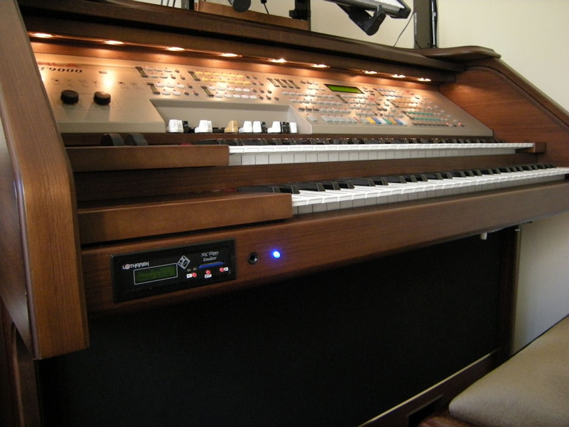

HxC fitted in Orla GT9000 LX Organ
andyg
Joined: Wed Feb 05, 2014 1:43 pm
Post by andyg »
HxC Fitted to Orla GT9000LX organ
The HxC needs to be configured as Akai S950HD interface format. It works flawlessly. :D
The SD card version is best for the organ in my opinion, as a USB sticking out of the front where the drive is located is simply waiting to be accidentally snapped off! Having said that, Orla went on to fit another off-the-shelf USB floppy emulator to their future models... So, what do I know? (!) :lol:
Andy
