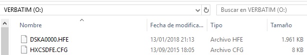

DONE. The same...Jeff wrote: Sun Jan 14, 2018 2:21 pm"Nor" means that you are in "normal mode". You have are definitively not using the right config file ! You must use the indexed version cfg file :DanielDOC wrote: Sun Jan 14, 2018 12:19 pmDone, but no luck (and with two pendrives).Jeff wrote: Sun Jan 14, 2018 1:21 am "HxC" only means that no image are loaded.
Check:
-that you are using the right indexed cfg file.
-that your hfe files are named DSKA0000.HFE, DSKA0001.HFE, DSKA0002.HFE...
- that your usb stick is formatted in FAT32.
Going back, for bypass errors, my firmware is well flashed? When I flashed it finished showing three times "888" (but less than 2 second between each, not like the error list), and then "Nor". it is good flashed? If this is OK, then my issue is other.
All the time I used FAT32.
Thanks again.
Use the one present in Config_Files/Indexed_mode into this archive :
EDIT : send me files present on your usb stick by email.
Note: I'm testing only with pendrive and the GOTEK powered with USB adapter. Not connected to the diskette original cable yet.

Re: Yamaha Clavinova and Gotek SFRM72-FU-DL
Ok. Have you tried another pen drive ?
And : Have you updated the device with the latest WIP firmware ? (the upd in the Next_WIP_Alpha_Firmware_And_Tools folder)
You may need to "clean" your usb stick before reformatting it.
Use the command line tool "diskpart" to clear the stick :
http://knowledge.seagate.com/articles/e ... Q/005929en
and then just reformat it.
Jeff,Jeff wrote: Sun Jan 14, 2018 6:13 pm Ok. Have you tried another pen drive ?
Latest firmware flashed. Cleaned stick via DISKPART. Tried other stick.
Nothing...
I'm waiting for an OLED screen, so if I can't test with indexed mode, I will test in normal mode when it arrives.
EDIT: Reflashed again with HXCFEUSB_V3_1_0_4a.UPD and in the same stick indexed HXCSDFE.CFG and DSKA0000.HFE and DSKA0001.HFE
Flashes finished and 000 appears, and I can select 000 and 001. Clavinova not show anything on Disk Orchestra panel (like no diskette is present).
Power down Clavinona and... AGAIN HxC! Can't load anything.
Maybe some jumper wrong configuration?
Good , normal behavior.DanielDOC wrote: Sun Jan 14, 2018 7:25 pm
No this sound like there is something wrong with the drive itself or with the usb stick. Sound like there is a bad contact/solder somewhere. Something with the usb path for sure.DanielDOC wrote: Sun Jan 14, 2018 7:25 pm Clavinova not show anything on Disk Orchestra panel (like no diskette is present).
The only needed jumper is S0 or S1. Nothing else. Remove all others jumpers.
