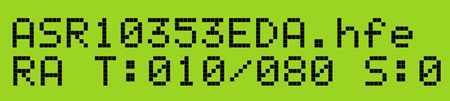

Today i received the new EPROM's 1.5B of Syntaur and working properly. This has allowed me to use the HxC file "ASR10353EDA.hfe" which earlier did not allow 1.0 EPROMS.
The problem now is that when the load reaches 10
At this point the load locks...
...and resets the ASR-10 display the message "ERROR 009 - REBOOT?"

I have understood that the error 009 is related floppy disk problems. Could be wrong the HxC? not appear, because normally load up to 10(of 80). Could be wrong file .hfe? others are not supported with this new version of the EPROM's. Can anyone give me one O.S. different?

Re: A potential new user of your products
retry with this one : https://hxc2001.com/floppy_drive_emulat ... 53_EDA.zip
Also : What is your jumper setting ? this should be set to ID0-A.

WORKS!!! :wink:
Still I have a problem with two keys ("KEYBOARD FAILED - TRY AGAIN?") but i managed to load the operating system and original sound banks that are on the Internet.
Obviously the last problem was a fuse, curious because i had tried a thousand times. I had mistaken the error 040, it does have to do with the floppy.
Thank you very much for your help and support, especially Jeff, logically. I am very happy :D and recommend if your device has a chance.

No, the problem was a combination of factors: the O.S. in HxC, the old EPROM's 1.0 in the ASR, and least, the fuse blow in the power board of the ASR-10.
From the first time i used the jumper in position ID 0. On the other, not work at all. And the position of floppy cable as it was originally.
