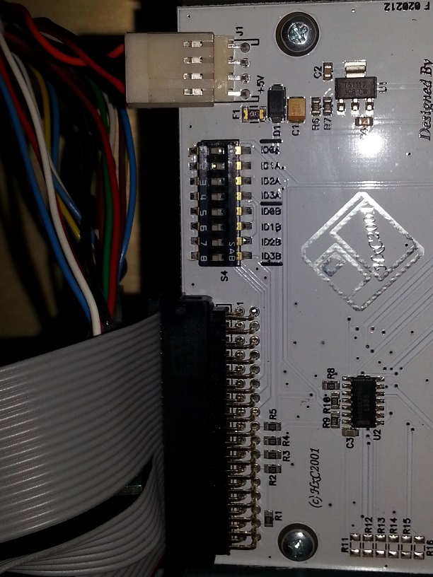

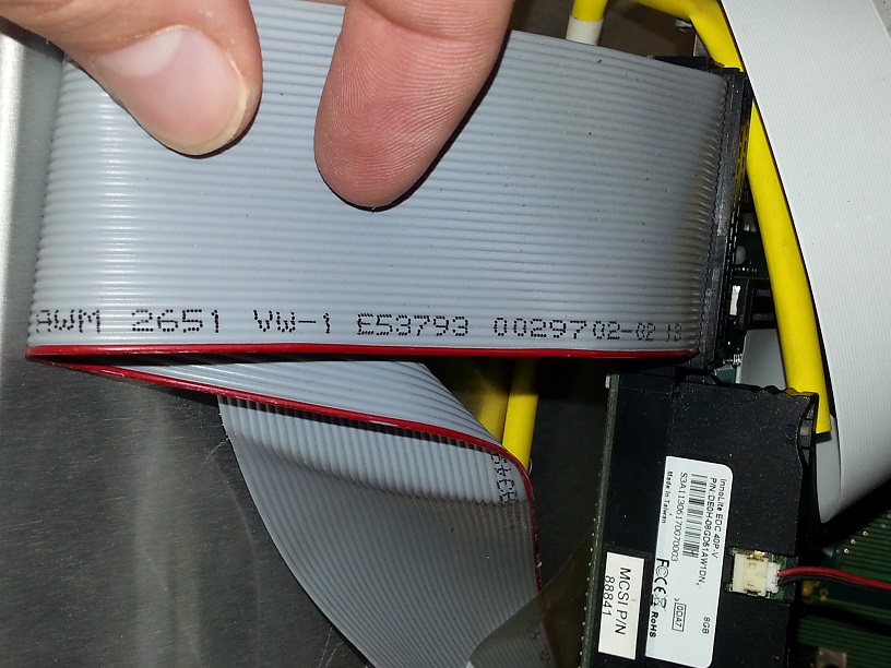

Attached are the pics you asked for.
Jon
Jon
- Text on cable that joins floppy emulator.
- 20140831_140130.jpg (176.33 KiB) Viewed 13749 times
- Switches as per last attempt.
- 20140831_140156.jpg (170.96 KiB) Viewed 13749 times

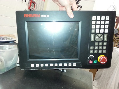

- Thee front Panel in-case you recognize it from previous projects.
- 20140831_140525.jpg (56.37 KiB) Viewed 13749 times

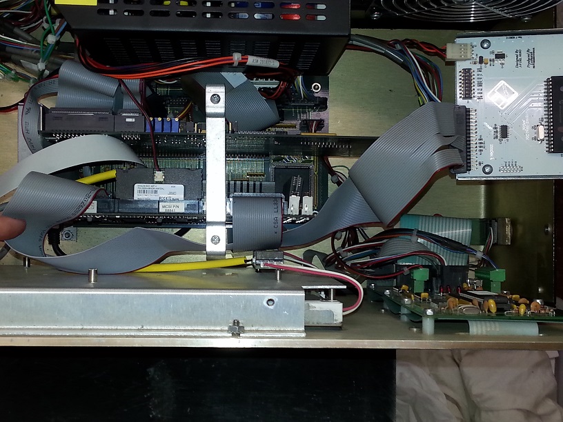

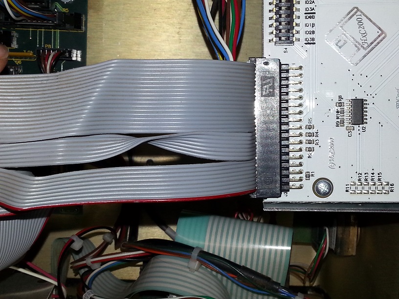

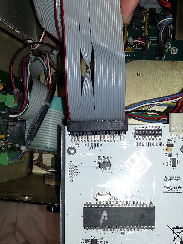

- Another view.
- 20140831_140051.jpg (216.55 KiB) Viewed 13749 times
- Twisted cable.
- 20140831_140100.jpg (211.99 KiB) Viewed 13749 times
- Inside of controller detailing whole cable.
- 20140831_140112.jpg (203.61 KiB) Viewed 13749 times

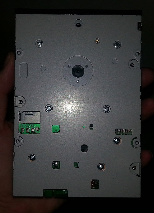

Basically last time I attempted to get this to work I installed the files you sent to the root of the SD card using my laptop PC, then installed the unit in the controller as per photos, installed the SD card, Powered up the machine and checked the drive powered up properly.
The emulator turns on OK, I then removed the SD safely, placed a file on the SD and placed the SD back in the emulator.
I then went into the controller and accessed drive A, the drive designation for the old floppy, the control unit tried to read but froze up for 15 minutes and couldn't see a file at all.
I then did the same with all the switch combinations you suggested, Powering off and on again, and the control couldn't read the emulator or file.
I currently have a working floppy drive with no jumpers visible from exterior see pictures.
please help,
Jon.
please help,
Jon.

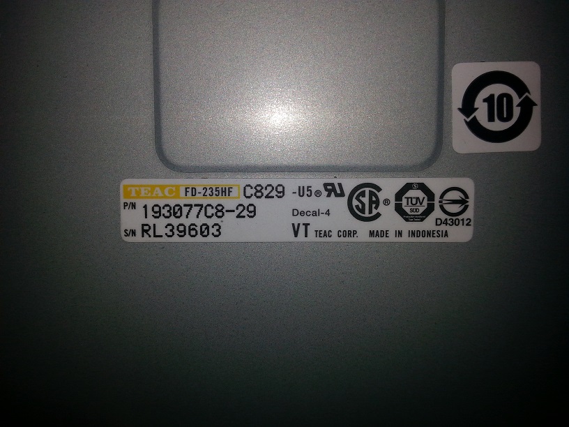

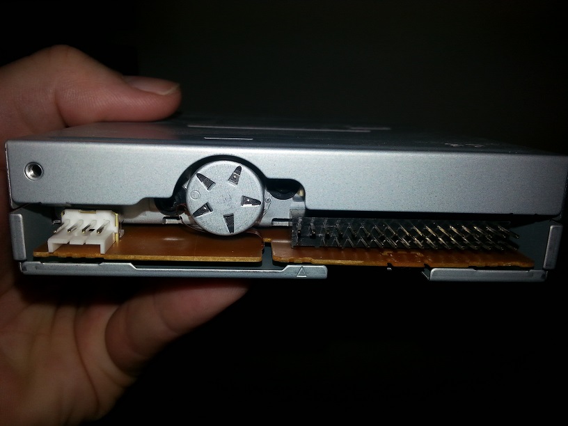

- Back face
- 20140831_143710.jpg (98.64 KiB) Viewed 13749 times
- Connections.
- 20140831_143702.jpg (100.36 KiB) Viewed 13749 times
- Model Number
- 20140831_143654.jpg (166.86 KiB) Viewed 13749 times
Re: Anilam 3000M/3300MK
The floppy ribbon is not connected correctly : the red write should be at the other side, at the pin 1.
Reconnect it correctly.
