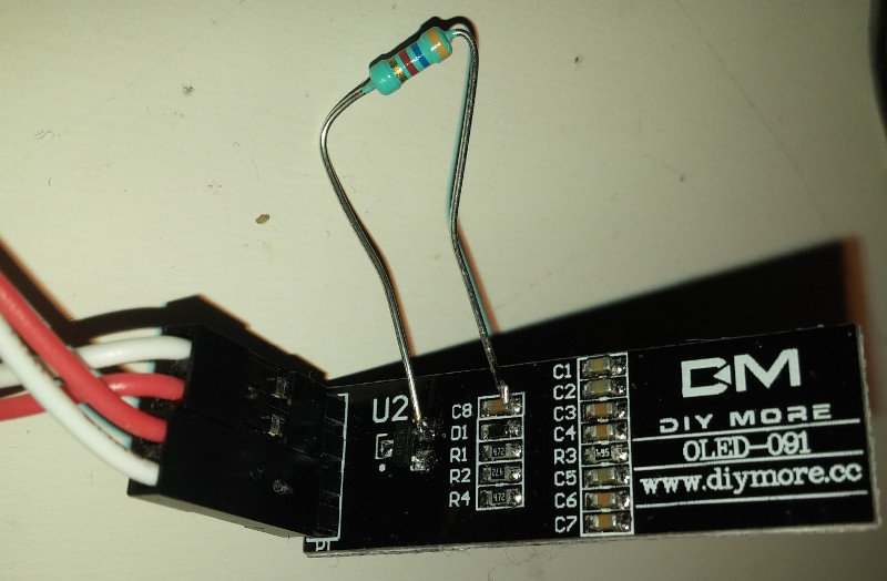

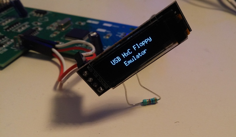

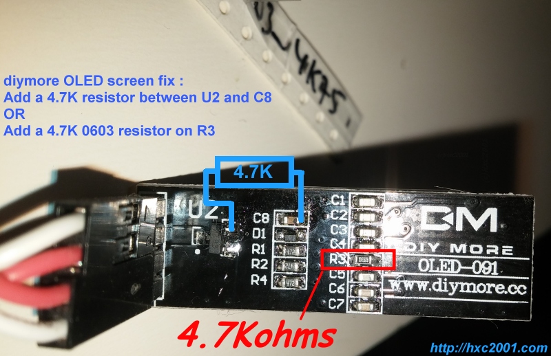

So i got time to have a closer look to this problem :
As expected the problem is the reset RC circuit. This screen have some curious RC part value which make the oled controller staying in reset a during a looonnnng time after the power up. The Reset RC circuit is done with C8 (4.7uF) & R3 (560K !!!!). Which give a time constant of 2.632 seconds. So no surprise here...
I have changed the resistor value to reduce a lot this time constant. ~4.7K ohms value seems to work reliably without any extra software delay :
First try :
The Fix :

"Myfriends" had messed up resistor values... as usual:
According to this diagram there should be 3x4k7 and 1x560k resistor. And there is, but one of 4k7 resistors is swapped with a 560k resistor!?! To be more precise R3 (R4 on the diagram above) and R4 (R1 on the diagram above) are swapped.
I'd also like to notice, that SDA and SCL signals accept 3.3V TTL logic, and have internal pull-ups (to 3.3V rail) and definitely should not be pulled up to 5V rail. There is a LDO voltage regulator on the board, so the module can be powered from 5V Vcc.
Re: Problem with OLED and Gotek
yes this is what i have suspected too, a silly mistake.
Btw the 4K7 resistor instead of the 560K on the IREF pin doesn't sound good at all according to the datasheet ! :?
tzok
Posts: 79
Joined: Sat Jan 27, 2018 2:52 pm
Post by tzok »
Indeed... it doesn't foretell long life of that display. I've just verified that swapping these two resistors does solve the problem (and doesn't noticeably affect the display brightness).
https://youtu.be/__3InV5tdzM
The IREF mistake may explain the brightness change i can see with a 3.3V power source...
Unfortunately few of the buyers will be able to exchange these resistors. :?
i am wonder how many of these faulty devices are in the wild now... I lot regarding the numbers of feedback i got !
This doesn't sound good at all this story...
ISEG = Contrast / 256 x IREF x scale factor
in which the contrast (0~255) is set by Set Contrast command 81h and the scale factor is 8 by default.
The magnitude of IREF is controlled by the value of resistor, which is connected between IREF pin and VSS as shown in
Figure 8-15. It is recommended to set IREF to 12.5 ± 2uA so as to achieve ISEG = 100uA at maximum contrast 255.
the voltage at IREF pin is VCC– 2.5V. (VCC = Panel driving voltage ~ 12V).
For sure with 4.7K these screens will have a short life...
