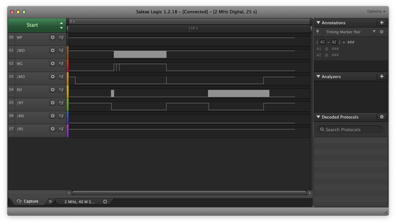

Re: 2.8" QD Disk Emulation
Post by etaoin »
trace
Schermafbeelding 2019-09-18 om 11.03.03.png (139.43 KiB) Viewed 1099569 times
etaoin wrote: Wed Sep 18, 2019 11:05 am:shock:
Et voilà ! :D : This was the Roland trick : They use the motor-on signal to clear the ready signal. I will check if this feature is common to all the QD drives or only present in model used by Roland.
This also explains the "Short ready" behaviour seen before.
I will check the qd drive i have here and decide if this should be set as an option or not.
Good that this last issue is cleared, i can work on something else now ! :D

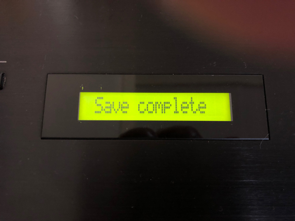

UPDATE: Success with sample dumping into S-220 the factory library then saving to Gotek USB except for saves that need more than one QD due to the verify errors. Work around is to save each Bank separately.
Just finished installing a gotek in my S-220. I notice I'm also getting verify errors every time, but it seems to save and I can reload a sound I recorded on the next boot up. I guess at this point we're just waiting for bug fixes?
z23 wrote: Thu Sep 19, 2019 2:30 am Just finished installing a gotek in my S-220. I notice I'm also getting verify errors every time, but it seems to save and I can reload a sound I recorded on the next boot up. I guess at this point we're just waiting for bug fixes?
This is fixed in the above firmware !
