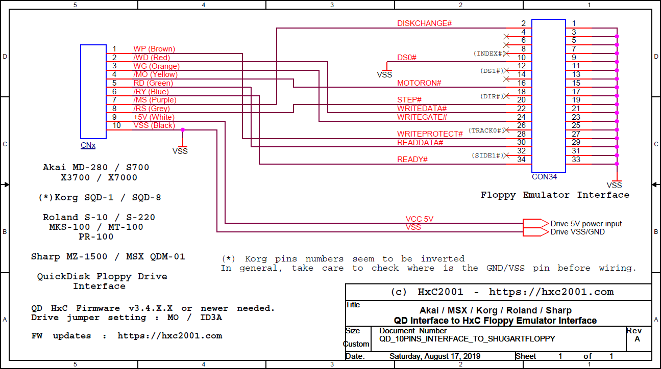

Re: 2.8" QD Disk Emulation
I have studied the different QuickDisk drive pinouts and it appears that the 10 pins version is the most commonly used.
Below you can found the QuickDisk Floppy Drive Interface to the floppy emulator wiring schematic for the following machines :
Akai MD-280 / S700 / X3700 / X7000
Korg SQD-1 / SQD-8
Roland S-10 / S-220 / MKS-100 / MT-100 / PR-100
Sharp MZ-1500 / MSX QDM-01
Yamaha MDF-1
If you have another machine and want to know which wiring you must use, just ask ! :)
