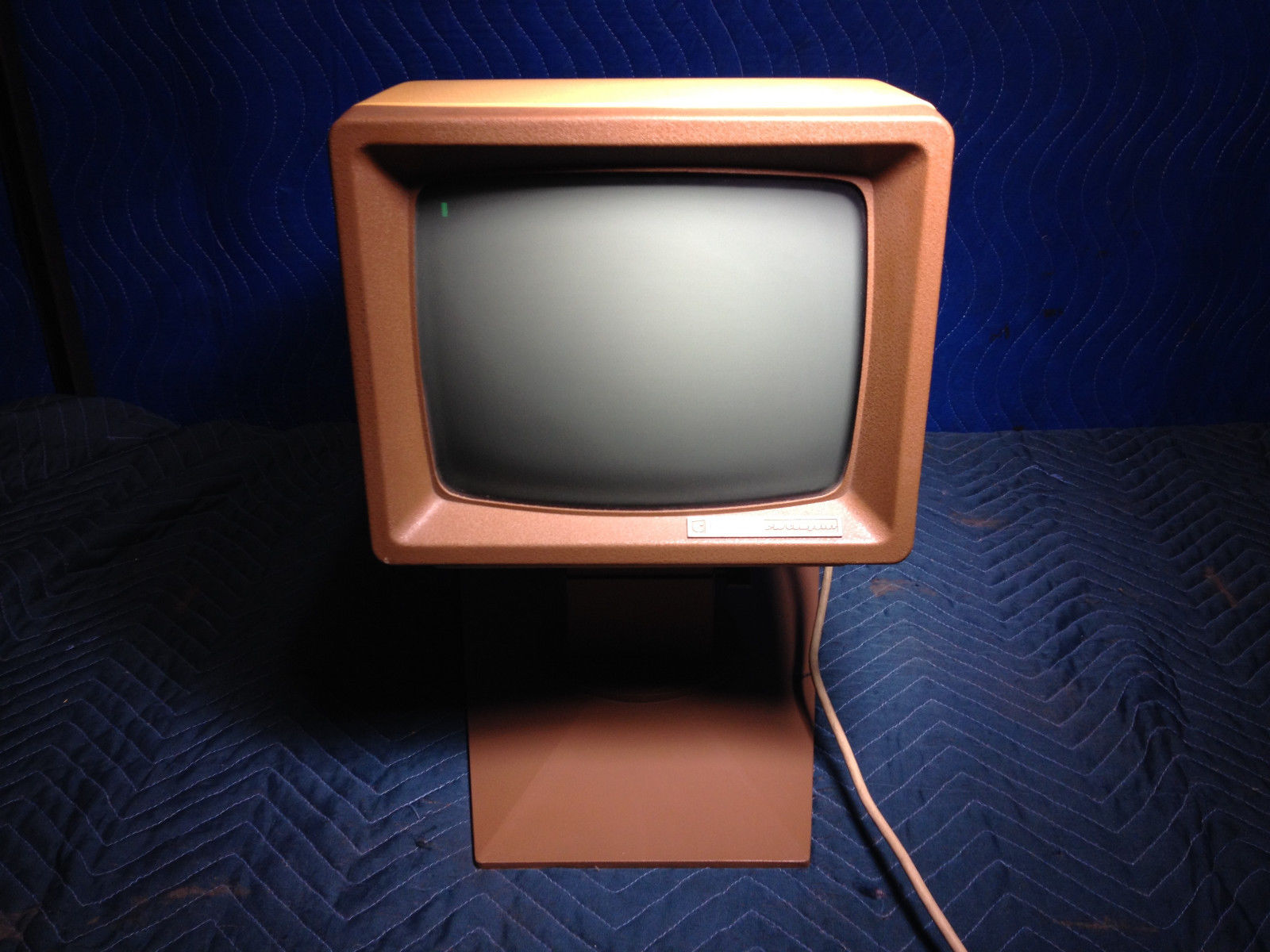

Can you make some pictures of this computer ?
Re: Cromemco format
Marcus would comment that all the photos I have for the C10 are on my website here
