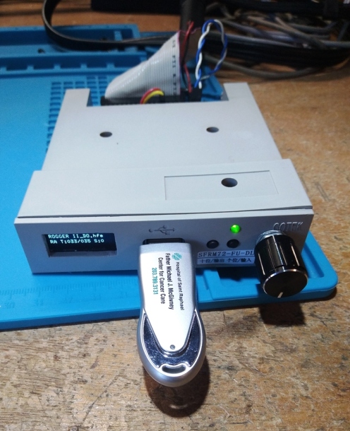

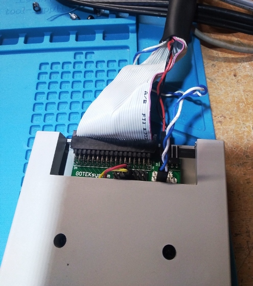

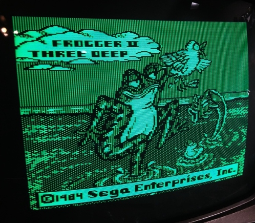

photo attached
- IMG_20231004_085315.jpg (170.14 KiB) Viewed 41714 times
- IMG_20231004_085259.jpg (150.87 KiB) Viewed 41714 times
- IMG_20231004_085251.jpg (156.19 KiB) Viewed 41714 times

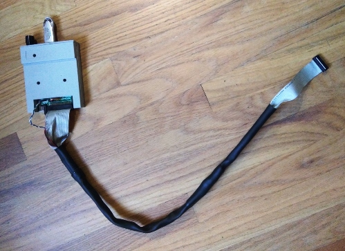

one more photo
- IMG_20231004_085340.jpg (120.09 KiB) Viewed 41713 times
