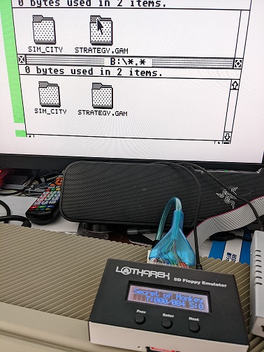

HXC SD MAX drive B showing same thing as A with selecting file on Dive A
Hi i recently bought a HXC SD MAX Floppy Emulator and works great but came across an issue in which no matter what is selected for drive A, B copies even when B was selected with different file, I tried following instructions with swiching dips 1 and 6 on and dont seem to work

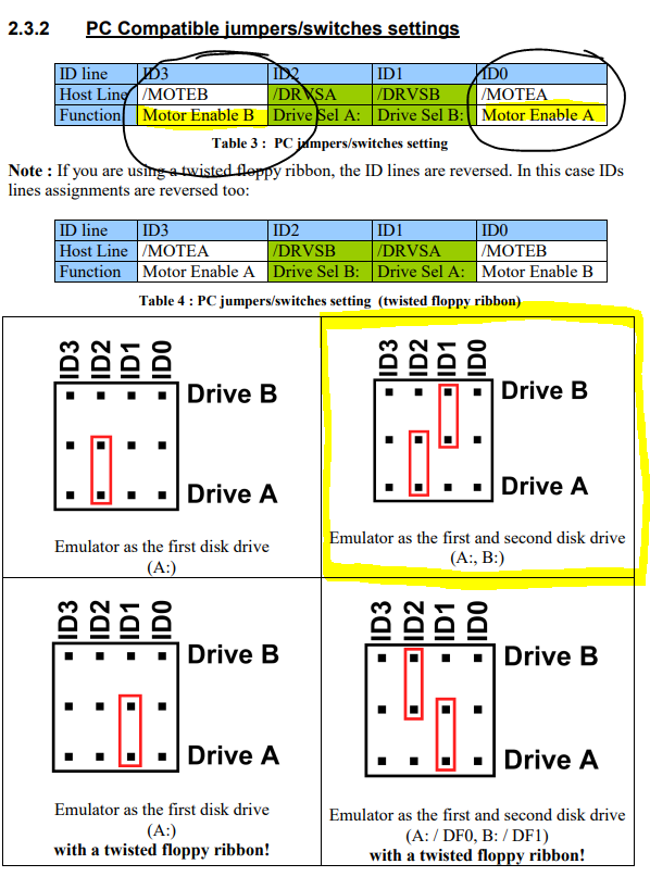

Bad switch setting.
try id0-a + id1-b
(is the internal drive still present ?)
try id0-a + id1-b
Re: HXC SD MAX drive B showing same thing as A with selecting file on Dive A

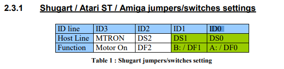

Internal drive is disconnected. I'm confused on what to set the dip switches to since the manual doesn't mention the HXC SD MAX settings (from https://lotharek.pl/productdetail.php?id=289).
n°1 and n°6Cronambs wrote: Mon Jul 18, 2022 1:53 am Internal drive is disconnected. I'm confused on what to set the dip switches to since the manual doesn't mention the HXC SD MAX settings (from https://lotharek.pl/productdetail.php?id=289).

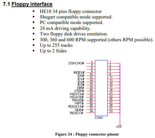

Doing a bit more digging found out the cable was made to emulate a PC floppy cable…
External cable wiring…
34 Way Connector on HxC = 14 Pin DIN Atari ST Floppy Connector
2 Density Select = N/C
4 Reserved = N/C
6 Reserved = N/C
8 Index = 4 Index Pulse (yellow)
10 Motor Enable A = 8* Motor On (dkbrown*) n°1/n°5
12 Drive Sel B = 6 Drive 1 Select (purple) n°2/n°6
14 Drive Sel A = 5 Drive 0 Select (dkgreen) n°3/n°7
16 Motor Enable B = 8* Motor On (dkbrown*) n°4/n°8
18 Direction = 9 Direction In (orange)
20 Step = 10 Step (grey)
22 Write Data = 11 Write Data (pink)
24 Floppy Write Enable = 12 write gate (ltblue)
26 Track 0 = 13 Track 00 (ltbrown)
28 Write Protect = 14 Write Protect (ltgreen)
30 Read Data = 1 Read Data (red)
32 Head Select = 2 Side 0 Select (white)
34 Disk Change/Ready = N/C
Any Odd Pins = 7 + 3 Logic Ground (black + dkblue) So no rewiring was needed except W300 & W301 on the Atari Ste mainboard needs trace jumper at pins 2&3 cut and a jumper added to pins 1&2. Dips need to be set to n°3 & n°6. If used on the internal ribbon cable then it is n°1 & n°6 but since it is wired as a PC interface cable then that would cause drive A to be always accessed along with drive B.
