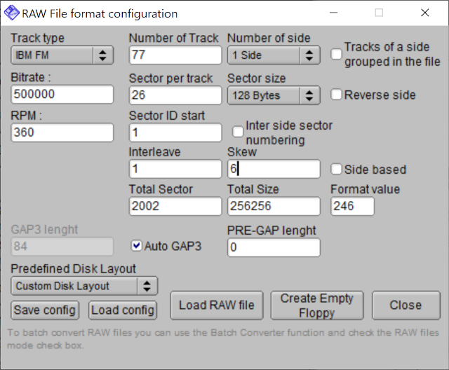

Well I solved that problem, it turned out I had a bad floppy controller IC. However, now I have another problem. I have attached all my files. Basically I create a disk image with the software as shown in the screenshot (Capture.PNG). The image as created (unformatted.hfe) works great in my test program. All seek, read and write tests pass. I then proceed to format the disk for CPM(formatted.hfe). The format succeeded, but then all seek, read and write tests got bonkers. Some pass, some fail. I am not sure what the format is doing to screw this up. This all works great emulating a SSSD 8" drive, but I am now trying to get it to emulate a 5.25" DSDD drive is giving me this problem. Any ideas? Thanks!

So I stand corrected. On the 8" disk. I can definitely read/write/seek on the unformatted disk, but after a format some sectors become messed up. Its a lot less errors than the 5" disk, but format still seems to mess it up just less drastically. Attached are the files for the 8" drive. Below is the format I am dealing with. Any help would be greatly appreciated.
