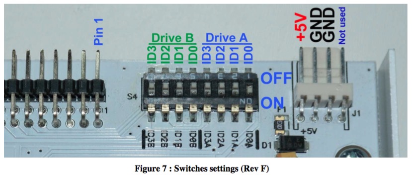

How should the DIP switches be set on the HxC MAX to be configured as drive 1 on an Emu Emulator I?
The MAX does not have jumpers like all of the other Lotharek emulators.
Is the MAX discontinued? I can't find any operating instructions for the MAX.
Is there configuration info available for the DIP switches? Please help!!

This isn't a photo from the HxC SD MAX but I believe the DIP settings are the same.
DIP Switch Settings.jpg (79.13 KiB) Viewed 41894 times

Drive A ID3 (DIP switch 4 on) is the correct setting to use with the HxC SD MAX when connected as the only drive on an untwisted cable.
