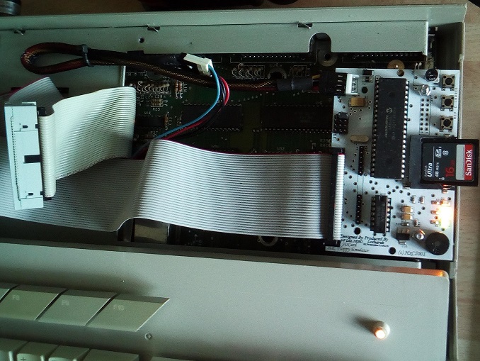

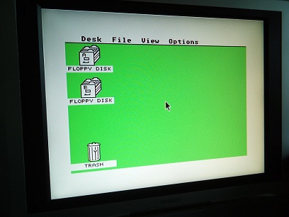

The computer doesn't launch the hxc emulator at all on the ST?
I have put the 2 CFG and Autoboot files onto the SD card which has been formatted in FAT32,
put it into the REV C of the computer, once you switch computer on, it just launches to GEM.
Should the floppy led light be on continuously after launch?
See pics below
Thankyou
Marc

Re: Atari ST 1040FM HXC Not Working?
I have also tried changing the jumper settings as per Lotherek's HXC guide from
1st, and to 2nd disk drives.
Have also cut the notch off of the extended floppy cable from Lotherek, to see if it
was plugged in the wrong way.
Thankyou
Regards
Marc
Don't understand what you mean to be honest?
The screen in photo is what happens on launch of emulator, straight to Gem, no HXC emulator present on Atari screen.
Sorry to sound dumb
Thankyou
Marc
Sorry to sound dumb
Thankyou
Marc

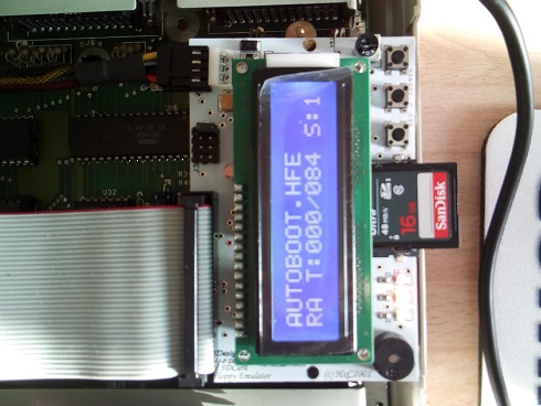

Think I understand, you mean the LCD Rev C screen, okay will do
Regards
Marc
Regards
Marc
HI Jeff,
this is what Rev C is doing on the LCD screen as in photo below.
When you press the left and right buttons, you get two beeps, nothing in
system, also the SD Card LED is red.
Many Thanks
Marc
Many Thanks
Marc
- IMG_20180313_HXC.jpg (147.92 KiB) Viewed 47471 times
Reconnect the floppy ribbon to the other way.
Reconnect at both ends, especially the pins that connect to the Rev C card?
Will have to slice some of the notch off, as only goes in one way.
Regards
Marc
Okay will try at the non hxc emulator end.
Thankyou
Marc
Thankyou
Marc
Exactly the same,
The LCD just displays AUTOBOOT.HFE, nothing else when you press the next and previous buttons,
red led light stays on the SD card access.
Regards
Marc
Regards
Marc
Wondering if there is a fault with the REV C board?
another picture please.MarkyB wrote: Tue Mar 13, 2018 8:40 pm Exactly the same,
Regards
Marc
