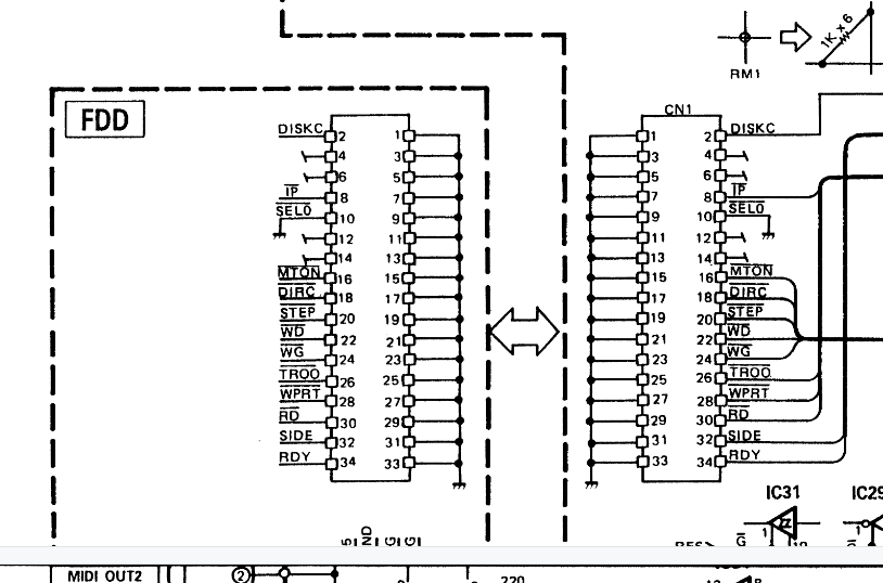

The Floppy is : toshiba nd-352s-a fdd4268g0k
From the service Manual of the QX3:
Re: Yamaha QX-3 midi hardware sequencer floppy disk conversi

Did some additional test. It looks as if the qx3 does not read the disks at all.
When a file is saved, you can see and hear that it accesses the disk. So I put 3 images on the disk. Saved a file to disk 1, read the disk status , changed to disk two, read the disk status. The status was the one from the previous disk.
Mink99 wrote:Did some additional test. It looks as if the qx3 does not read the disks at all.
Disk change detection not working -> Bad interface mode, or floppy ribbon wire n°2 broken.

Post by Mink99 »
So I should go to custom mode, and set pin2 to some "disk change mode" , but which one ?
Same for pin34 on some ready mode?
Try out all permutations or is there already some experience ?
The cable and the pins work fine as the fdd works fine as well ....
Mink99
Posts: 9
Joined: Mon Oct 14, 2013 1:52 am
Post by Mink99 »
A dos floppy cable has two plugs, one twisted and one not. As shugart drives are in reverse order, pin1=34 etc do. I have to use the twisted plug on the straight one ? This might be something that is not documented.
