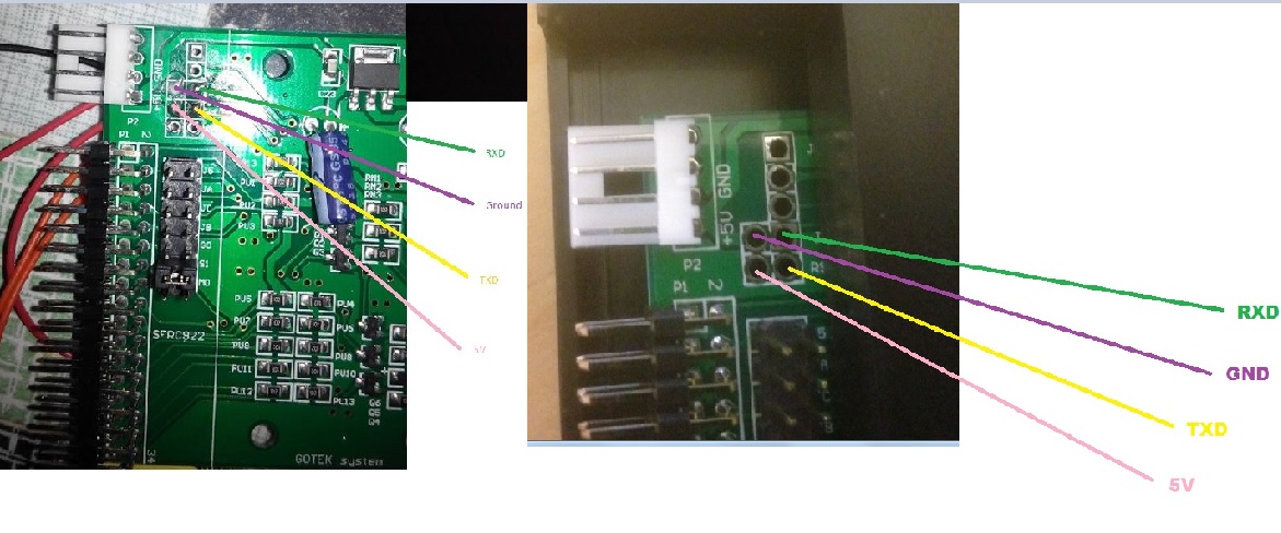

Hi folks.
I've been browsing and a-googling, and I thought I'd be able to fix this without bothering someone else but it appears it's inevitable. Considering there are several Gotek devices, probably someone else has encountered this problem, but I couldn't find it searching through the forum. If a solution is here, and I've missed it, I humbly apologize and would greatly appreciate a link to the relevant thread.
So, I bought a Gotek SFRC922B and thought hey baby it's gonna be great to get that old sampler working again, completely overestimating my own abilities as usual. I then bought an FTDI USB/TTL converter and borrowed the electronics lab at work, sat down to solder and realized my Gotek device is different from those in the pictures I've seen on various forums and youtube vids. Also, I can't find the relevant points (TX, RX, VCC3v3 ) on the Gotek device, while all the points are properly marked on the USB/TTL converter. I thought I'd just be a good monkey and follow the pictorial in this link: http://www.vogons.org/viewtopic.php?f=46&t=43416 but the pins/points that has been soldered here are in a different layout in my device, and they're not marked...
Is there some general information about where to find these pins/points on such devices I've missed out on? Or are the schematics of the Gotek device available somewhere?
Any help would be highly appreciated.
Edit: Added a photo comparing the 922 and 922B. Can I assume that the two top ports are 5V and GND and that the two directly beneath those are TXD and RXD? Doesn't really make sense, because what I've assigned as TXD is marked as RS.
- welcome to nooborama.jpg (168.08 KiB) Viewed 33193 times
Re: Gotek schematics
You don't really need the schematics to the Gotek. Just use a continuity tester to find which header pins lead to which pin on the STM32 chip. The STM32 chip pinouts are published so they'll tell you which pin is TxD and RxD, and then the continuity tester will tell you which header pins correspond to the STM32 pins.
In other words, easiest way is to actually find TxD and RxD on the STM32 first and then try all 7 header pins until you find which pins match. STM32 programming isn't really my area of expertise, but I believe you'll be successful locating it this way:
With the Pin 1 dot of the STM32 in the upper-left corner, PA10 (RxD) should be the sixth pin down the right side and PA09 (TxD) is the seventh pin down the right side. RxD/TxD are labelled relative to the STM32 chip, not the programmer, so the TxD of the programmer should talk to the RxD of the STM32 and vice-versa.
Hopefully that makes sense.

Hey , new to the forum so first up, hello
Ok, so I just got my Gotek drive, opened it up and found it was the same PCB layout. Mine is a SFRC922C , so clearly they change the board layout from B onward. Anyway I just finished programming mine without any issues. Here's a picture of my board and the points I used just to help anyone else out.
Cheers
Cheers

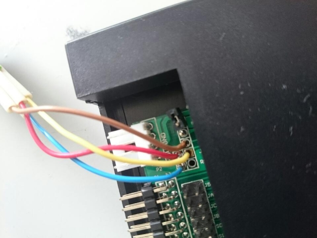

Hey can you send me your schematic, or a pic of your soldering points? Your image expired and I have this rev C board!
Red - + 5V
Blue - GND
Yellow - data TO device (Computer TXd line)
Brown - data FROM device (Computer RXd line)
Closed jumper - bootstrap mode
Unused pin pinhole - reset (negative logic)
Blue - GND
- Gotek flash.JPG (138.47 KiB) Viewed 32036 times

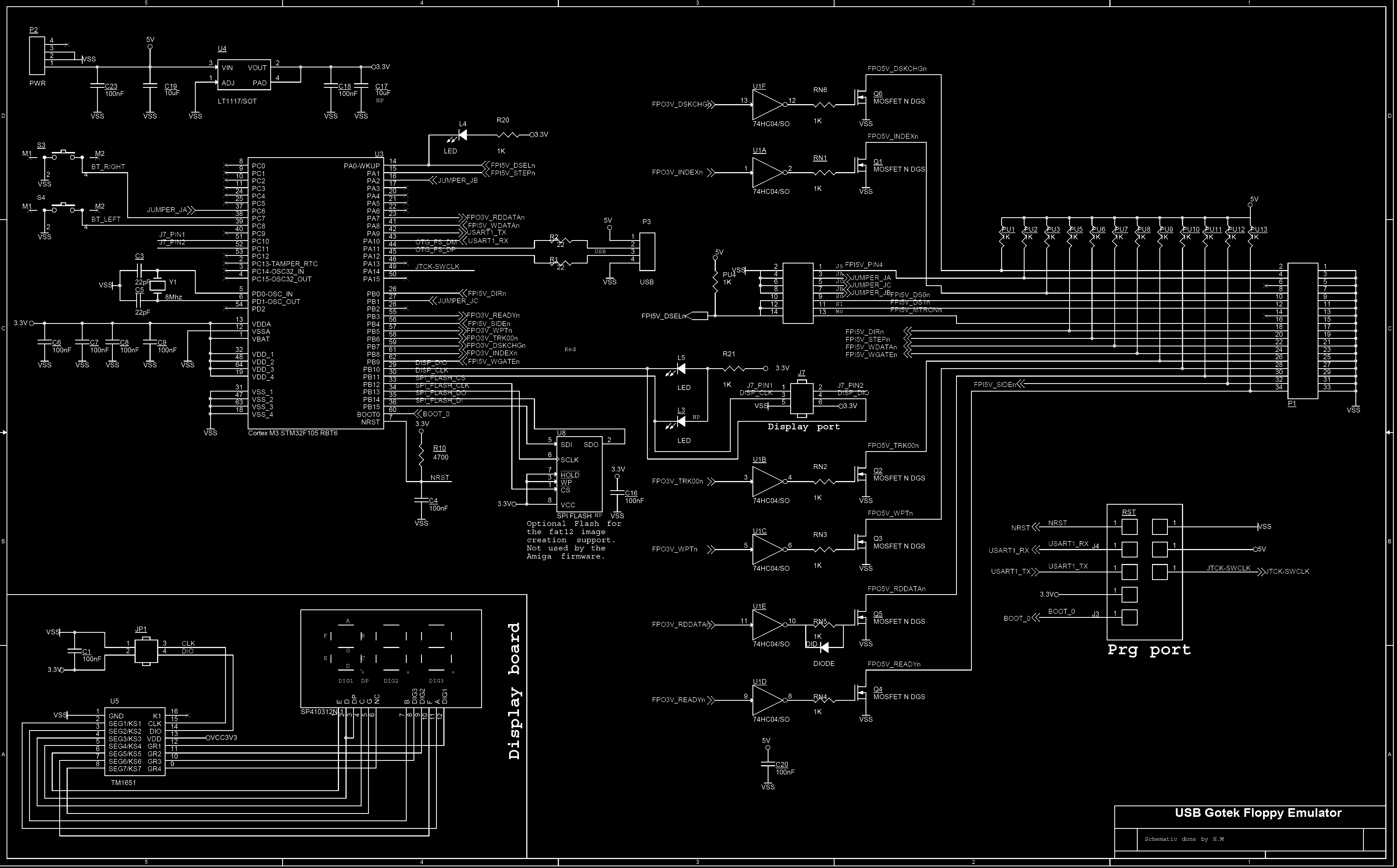

Schematic...
- gotek_usb_floppy_emulator_schematic_BW.jpg.png (103.61 KiB) Viewed 32036 times
Is original schematic for gotek floppy?
