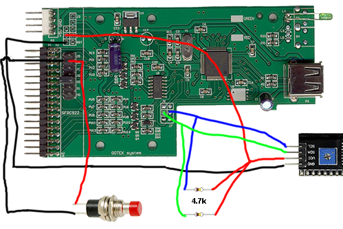

Hi all.
I just ordered an LCD and the other parts to add to one of my Goteks.
There are some good references out there on how to connect it up. But not a good diagram.
I mocked up one and am looking for confirmation it is right. If it is I will take good pictures of the project and post here.
Gotek LCD Mod Diagram.png (252.74 KiB) Viewed 30760 times
I am figuring the Enter switch need to be grounded?
Ron

The ground is at the jumper place..

Got it. Thank you!
I got all the parts in yesterday and wired it all up. Works perfect first time! :D

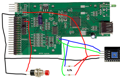

The modified diagram is below:
Gotek LCD Mod Diagram.png (244.94 KiB) Viewed 30725 times
Now, where and how to mount it. ;)

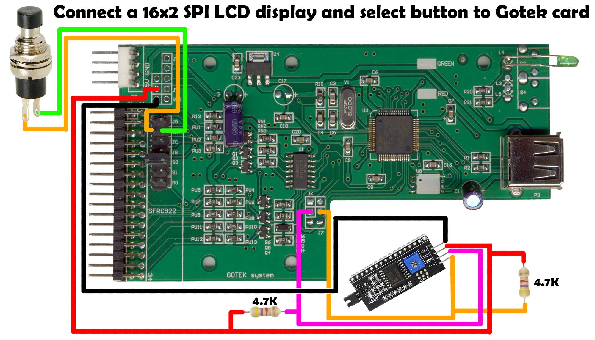

Decided to help where I can in this forum, so for now it must be redrawing schematic.
Redraw of rfancellas schematic image

Wow, very nice! Thank you!
