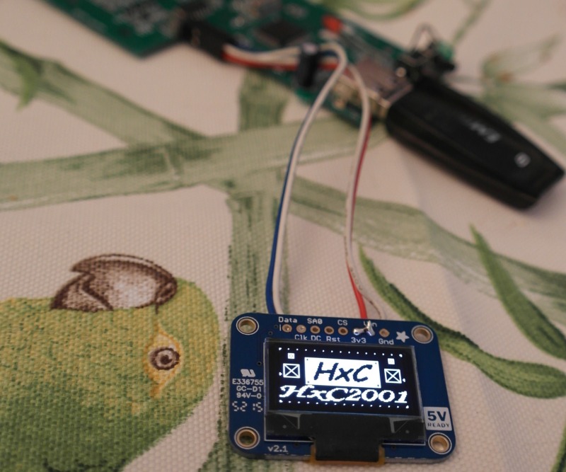

Re: New Alpha version Firmware - Volunteer Testers needed !
Screens received !
Work in progress !
:D

cbrunschen
Posts: 17
Joined: Sat Oct 16, 2010 11:10 am
Post by cbrunschen »
That looks great!
By the way, the displays more commonly used in the OLED mod are 128x32 pixels in size (using half the capacity of the SSD1306), the one you seem to have in the picture is the 128x64 pixels (using the full SSD1306 capacity); it might be good to be able to specify (in a configuration file perhaps) the type & size of display, possibly even the sub-section of the display's pixels that are visible through the LED aperture in the floppy drive, to allow for positioning of the display.
Best wishes,
// Christian
cbrunschen wrote: Sun Sep 03, 2017 6:29 pm That looks great!
Best wishes,
// Christian
Sure, for the moment the default resolution will be 128x32. That's just that my only 128x32 screen got an "accident"...
