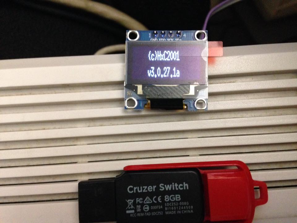

New firmware allowing you to choose the "screen resolution" up to 21x2 characters on the OLED screen:
https://hxc2001.com/floppy/forum/viewtopi ... 306#p16306
:wink:
16 September 2017: Firmware STM32 USB HxCFloppyEmulator v3.0.27.1a
- Extra LCD resolutions and sizes options added :
- 2x16 characters (for 2x16 or 2x20 I2C-HD44780 and 128x32 OLED screens)
- 2x18 characters (for 2x20 I2C-HD44780 and 128x32 OLED screens)
- 2x20 characters (for 2x20 I2C-HD44780 and 128x32 OLED screens)
- 2x21 characters (for 128x32 OLED screens only)
To select the desired resolution, enter the internal menu, and choose the "LCD size" sub-menu.
- To enter the internal config menu you can now press both up and down buttons. (without usb stick inserted).
- The internal config menu can now be browsed without the selection button, just wait 4 seconds to select an item.
- SD HxC Floppy Emulator internal EEPROM emulation added : The parameters changed into the internal config menu are
now saved into the Flash memory and restored/used at power up.
- Some more internal optimizations.
https://hxc2001.com/download/floppy_driv ... _notes.txt

Just got this information : it seems that some 128x64 screens are directly compatible the current firmware version without any change.
This is not the case with the 128x64 i got here. the screen matrix is probably connected differently.
http://www.ebay.com/itm/0-96-I2C-IIC-Se ... 2214169156

Very nice, but much effort because of two characters more width of the display, the OLED display is usually in two minutes built in the original housing .. :shock:
Re: OLED mod
Kingstener wrote: Mon Sep 25, 2017 1:33 pm Very nice, but much effort because of two characters more width of the display, the OLED display is usually in two minutes built in the original housing .. :shock:
Not 2 more, but 5. You have the option to display up to 21 characters with the hxc firmware.

Jeff wrote: Mon Sep 25, 2017 3:55 pm Not 2 more, but 5. You have the option to display up to 21 characters with the hxc firmware.
then it is worth, these settings i had not yet been discovered

Kingstener wrote: Mon Sep 25, 2017 5:23 pm
Remove the usb stick, press both buttons. You have then access to tons of options. there is an lcd section.

Jeff wrote: Mon Sep 25, 2017 5:36 pm Remove the usb stick
yes, that was the decisive step ... :-)) cool..

What is the exact OLED display size, which can replace/fit the current original 3 digit LED display hole without being forced to buy a new cover or modify the current cover?

teevee wrote: Wed Sep 27, 2017 8:09 pm Summa summarum:
Probably doesn't exist. Just take the one above and set the 16x2 display mode (this is the default one). No need to modify the box with this setting.

Okay, I found this topic (Link) and here the blogger mentioned:
For aesthetics I recommend using a mini OLED display which will fit in the original gotek LED display cutout, therefor not requiring the external LCD clip-on drive cover holder. http://www.ebay.co.uk/itm/302110929185
The blogger is linking to something called "0.91" IIC I2C Serial SPI OLED LCD Display 128x32 3.3V/5V AVR PIC STM32 Arduino"
Re: OLED mod
This is just the normal one i have specified into the documentation :
https://hxc2001.com/docs/gotek-floppy-e ... -oled.html
http://www.ebay.com/itm/302110929185
