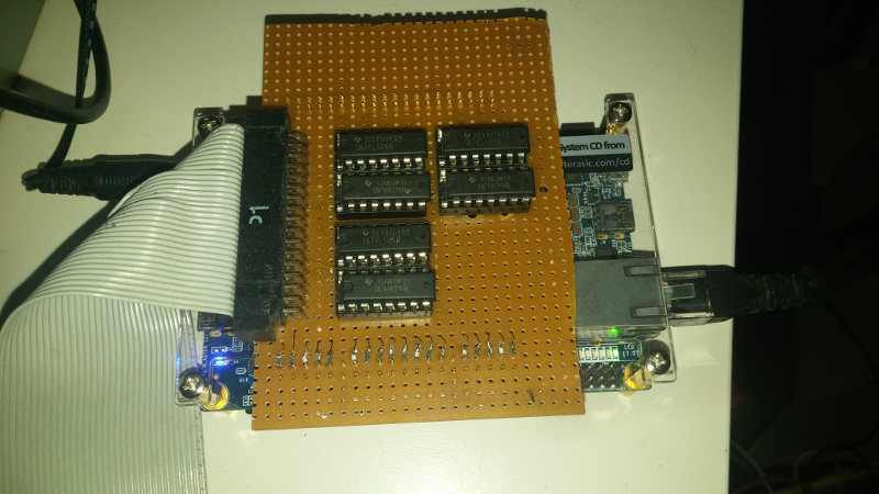

Jeff wrote: Mon Apr 29, 2019 10:48 am The frequency of QD disk is well above the 22khz (this generally something around 100Kbits/s). i am not sure that the tapuino can deal with this.
Anyway i have now something working to dump/write and simulate QD disk drives (and ANY others kind of floppy disk drives :wink: ) without any issue. :D
This floppy simulator/reader/writer is based on a de10-nano board and a buffers piggy-back board. This one will be sold by Lotharek.

Yes. Most of the product is already there since this is based on a de10-nano board. The piggy-back board prototype is quite simple to make if you are able to solder some ic on a board.

I have currently no gerber ;) :
(less buffer ic are needed if you only want only QD Disk emulation.)

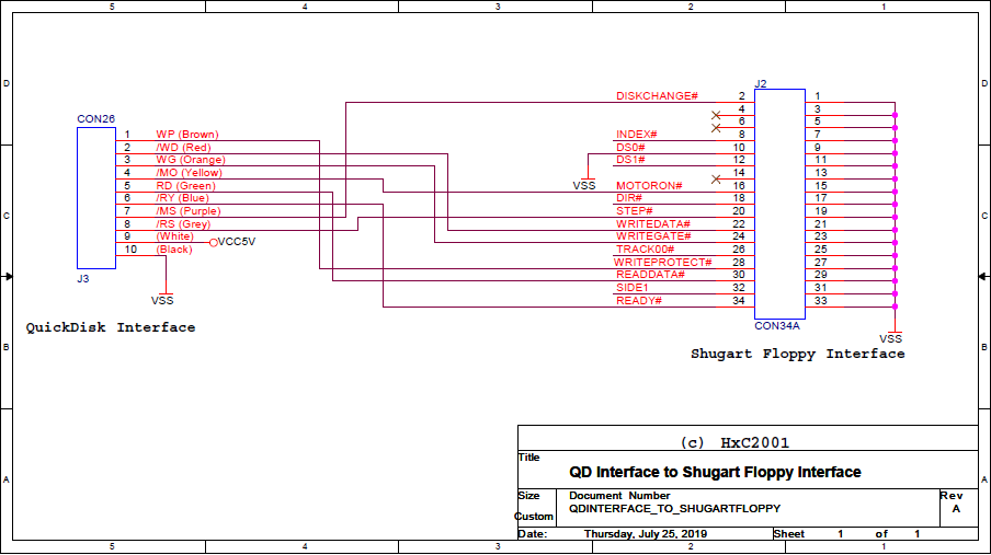

QuickDisk Interface to Shugart Interface adaptor (To use with the HxC Floppy Emulators supporting the QD emulation).

Also, a question about Jeff's schematic: my understanding is the QuickDisk drives need an external input to trigger a disk scan. This is /RS, connected to the Shugart STEP output, right? Does the drive generate any kind of signal to indicate that the disk has been completely read, or is it up to the drive controller to know how much data to expect?

Here it is my reverse engineering results on a Thomson QD90-128 / Kanto Denshi QDM-01 QuickDisk drives :
-- QD90-128 / QDM-1 / Akai MD280 Quick disk signals description
-- (C) 2019 Jean-François DEL NERO / HxC2001 Floppy Emulator project.
-- DB9 Connector: (QD90-128)
--   /MS /WP /MO /RS  WG
--    1   2   3   4   5
--       6  7   8   9
--     GND /WD /RY  RD
-- Internal connector :
--  - (1-Brown) /WP - (2-Red) /WD - (3-Orange) WG - (4-Yellow) /MO - (5-Green) RD - (6-Blue) /RY - (7-Purple) /MS - (8-Grey) /RS - (9 White) VCC5V - (10-Black) GND -
-- (O AL) 1 (7) MS : /Disk Present (Simple switch to gnd + 4.7Ko pull up)
-- (O AH) 2 (1) WP : /Write Protect (Simple switch to gnd + 680o pull up - Lock the write-gate if asserted)
-- (I AL) 3 (4) MO : /Motor ON     (Motor on trigger signal on falling edge - Motor stopped by the stop motor switch if MO not asserted OR if WG is asserted )
-- (I AL) 4 (8) RS : /Reset        (Stop motor if /MO not asserted + clear ready)
-- (I AH) 5 (3) WG : Write Gate    ( If WG is asserted the motor seems to stop at the stop motor switch even if /MO is asserted ! No write occur if the drive is not ready (/RY) and the /Write protect is asserted )
-- -----  6 (10) GND
-- (I AL) 7 (2) WD : /Write Data   ( Falling edge )
-- (O AL) 8 (6) RY : /Ready - Enabled if /MO is asserted and pass the rd head sw signal. Cleared at /RS or when passing the stop motor switch
-- (O AH) 9 (5) RD : Data Read
--          (9) VCC (5v)
So yes, you need to "launch" the motor and wait the Ready signal to read a full track.
