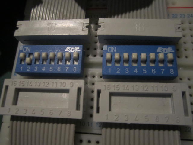

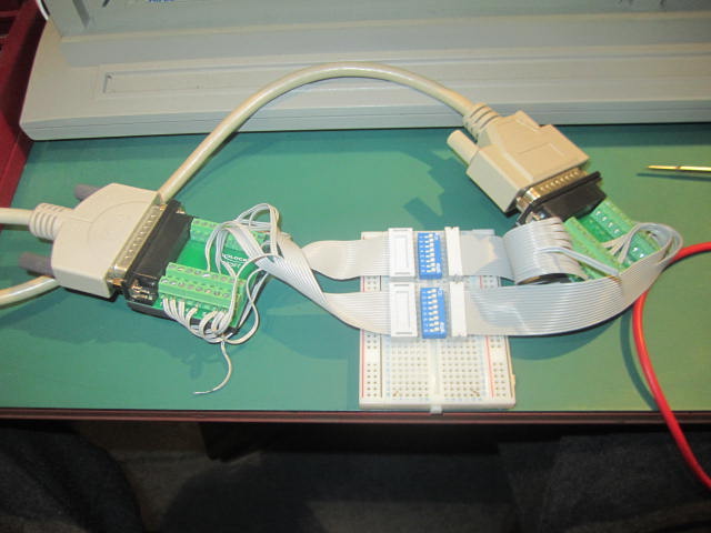

I think I solved the problem with the ground loop. I made a little set up with a breadboard, two D-Lock sub 25 connectors, two dip switches, two parallel D-sub cables and some flatcable.
Pic:
a total of 15 wires to pin: 1/2gnd/3/5/7/8/9/11/13/15/19/21/22/24/25
All is connected according the Jeff McClintock wiring scheme.
Pin number two of the >FZ to FZ< cable is the culprit as one might have expected. It's the ground pin-out. Disconnect this one and the 'hum' is gone.
another pic:
But there's a but. You can't exchange data between both samplers when the ground pins are not connected. You will get an error if you do. So all what's needed is a single switch to "lift ground" like in a DI box or put a resistor in between. With this set up I'm gonna see what is the best solution.
I think I just will make a neat little box with a nice little switch on top because of the possibility that with a resistor data might be corrupted or time errors will appear and I assume that when I use a switch there definitely will be no humming noise at all. I don't know if this will also work with the FZ to PC cable to get rid of the ground loop. Talking about this, you've got mail.
